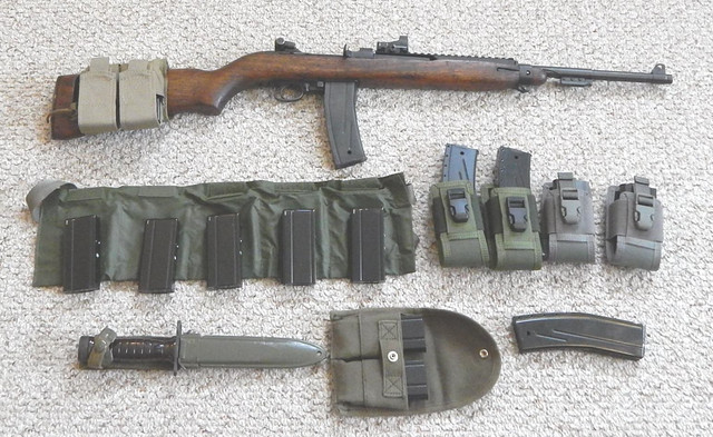

I chose the M1 Carbine to replace my AR 15 due to the OIC. I had read a lot of opinions about other 5.56mm rifles and their assorted problems, so I went old school. Plus I mounted a Burris Fast Fire 3 on my main rifle, excellent option. I don't win any 3 gun matches with it as it is not as economic as many of the 5.56mm choices, nor does it have a large choice for competitive mag pouches. But it is FUN and I get style points! I use the 5/30 mags for matches and the 5/15 mags for zeroing and load development.
