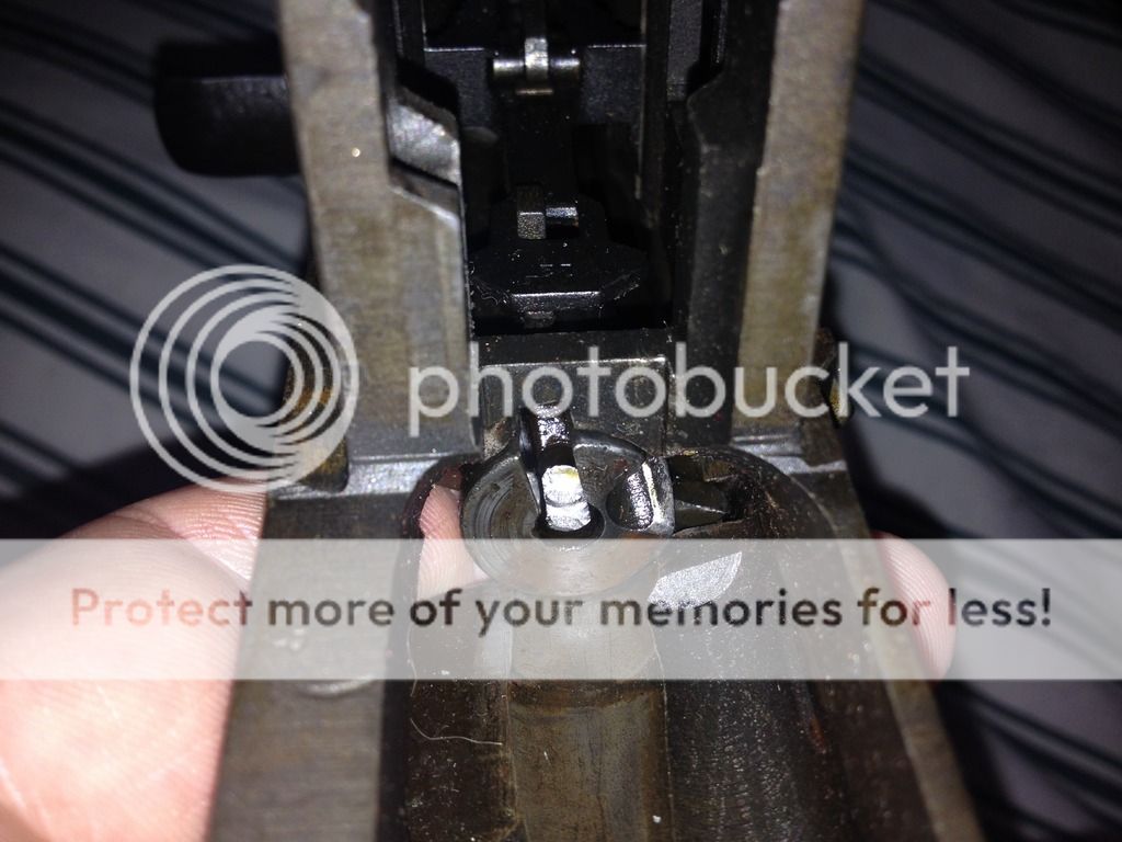

M1 Garand broken?
Look at the hammer. It looks like the top half. The pin helps close the bolt if not fully closed and prevents out of battery discharge.

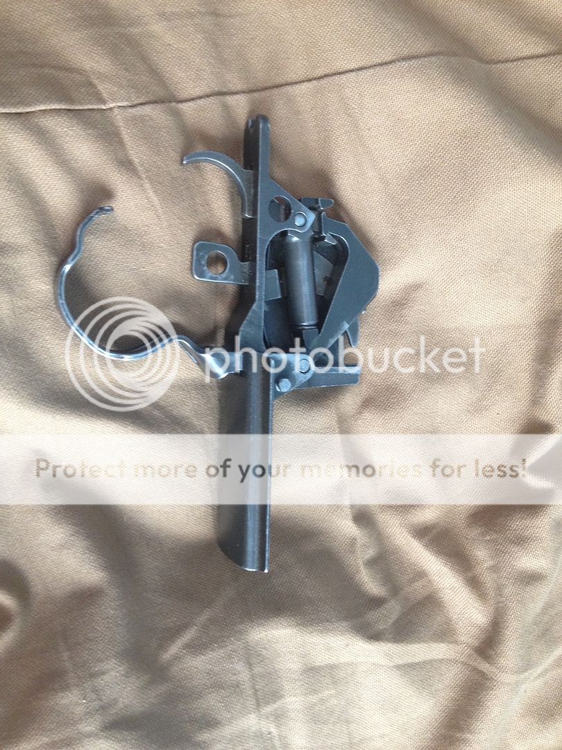

back of the firing pin, that is whats broken, can you take some pictures of your trigger group as well? also for the love of god dont fire it anymore, it looks bone dry, the thing needs grease to run properly.. i am in toronto if you need help with that bolt and swapping the firing pin.
looks to me that you maybe right.
it is a broken firing pin
you can see in one of the pictures the end of pin is clearly broken off, bolt looks fine, rusty and no grease in there but fine... he needs a new firing pin.

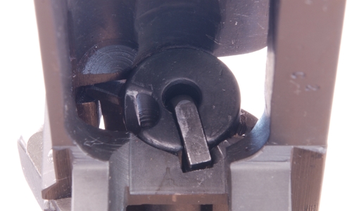

this is a good pin
compared to yours
I'm wrong Serb is right :) don't try firing it because if the pin gets stuck you will get an unwelcome surprise. Easy fix at least!
Alright thanks for all the help, I was shooting MFS .30-06 FMJ. I will order the parts and oil her up!
