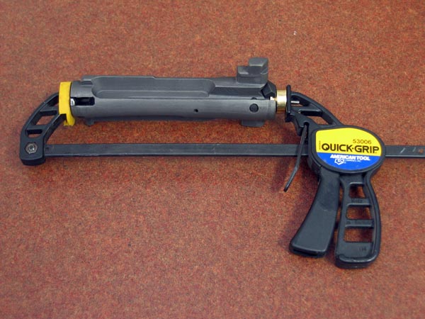

You can make some tools too. I made a bolt assembly/disassembly tool using a quick clamp and a head from a 30-06 case. Works like a charm.
