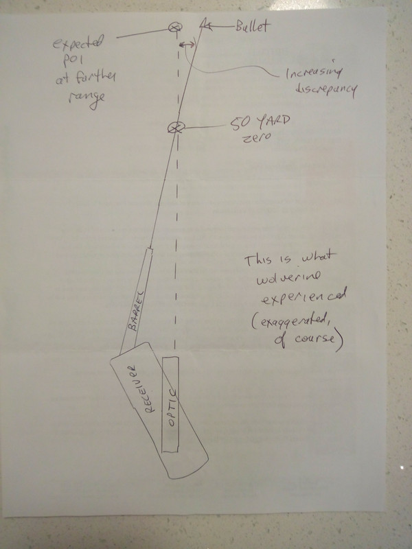

[FONT=&]So, I originally sighted this rifle in when I got it at somewhere between 30 and 50 yards, and noticed at the time that it was shooting to the right of where I would have expected based on both the iron sights and optic I had installed. I didn't think much of it, and adjusted the optic to match the point of impact. However, after seeing a post by Wolverine Supplies yesterday noting that their barrel was not aligned properly, I took a closer look at mine, and the barrel is visibly canted to the right when compared to the handguard. I took it out again today and tried it at 100 and 200 yards, and despite it being zeroed as it was, it is shooting quite a bit right at 100, and considerably farther to the right at 200 yards. It's not as far off target as Wolverine's seems to be, but it's still not hitting anywhere near where it should be.
I contacted M+M this afternoon - I'll let y'all know how well they stand behind their product!![/FONT]
I’m trying to figure this out in my physics challenged brain. If the barrel is canted to the right and the optic rail isn’t straight (off to the left), so long as the optic is zeroed at 30 or 50, wouldn’t it also be zeroed for 100 and 200?
Ugh… I should have paid attention in school.
This is a real question, I can’t figure it out.
Edit to add:
A precision rifle forum has the answers: it puts the sight off axis, and that does cause deviation the farther out you shoot. It shouldn’t be that much tho, an inch or two at 300 from a 50 yard zero.
Being five feet off target, or 8 inches, means something is shifting.
Edit to add:
That calculation is incorrect. I don't think anything is shifting, or if it is, I don't think it's the problem with varying POI at different distances. Geometry of this rifle and handguard is interesting - if the barrel is canted, then the barrel is actually angled within the handguard at roughly the halfway point, meaning that (in my rifle's case) the POI is shifting 1mm (probably less than 1mm in reality) to the right for every 300 mm the bullet travels in relation to the expected POI in the optic. The optic is mounted at a different angle than the barrel, as it's on the aluminum shell. I'm not explaining it well, but it makes sense in my head. I need to draw a diagram...
