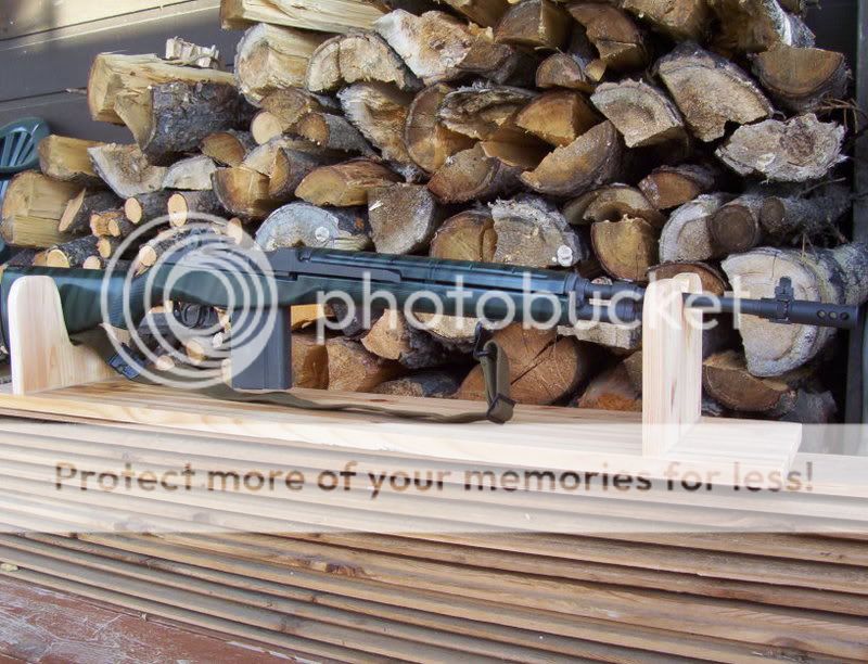

Use a norc or G.I flash hider, scrap the navy sight and keep original irons. have your gunsmith lightly ream the inner flashider splines so they will clear the shorty barrel threads, there is no need for new splineways to be cut oin the barrel, there is enough meat inside the flash hider to ream and cut the 1/2 x 28 tpi threads. drill and tap underneath on what would be the bayone lug base and install a set screw. have a thrust washer fitted where the castlenut would go..... and voila..... you have a standard flash hider on a norc shorty.
Misanthropist gets all the credit for dreamin this up, custom work done by Dlask Arms..... for CHEAP .. it works.... and I like it. My shorty has been adapted this way using a G.I. flash hider.
It's true, I just reuse the original flash hiders now.
All you do is swing by a machinist, have him bore out the flash hider to 1/2"x28 tpi thread, and screw it back on the barrel. You pop a compression washer in where the castle nut goes, and adjust the indexing of the sight by either cranking the hell out of the flash hider, or by lapping the compression washer down on a sharpening stone.
I guess I should do a write up for you guys.
It's funny, for ages people kept telling me how this wouldn't work. Luckily I ignored them as it works great! I won't be buying any gas lock front sights any more, myself.
