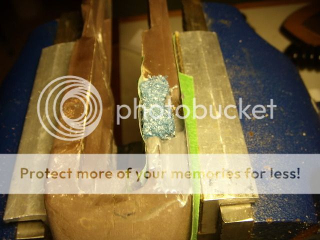

Hence this operation:
Side dam building where FA fun parts / connector rod used to be....

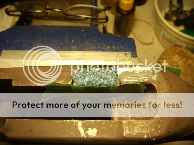

Masking tape is your friend....
Then come back and smooth things over, especially if you use JB Quick (sp?) and you have 10 minutes to work with....

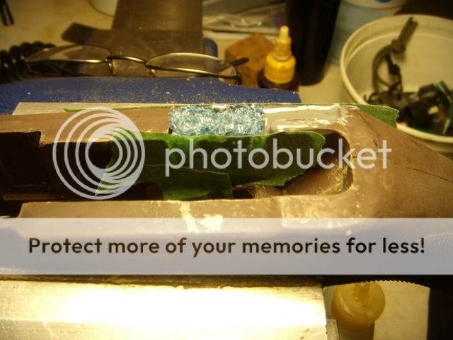

Another view of filling in the FA gaps....

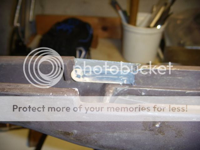

And finally, the popsicle stick fix..... WITH a popsicle stick, no less....
