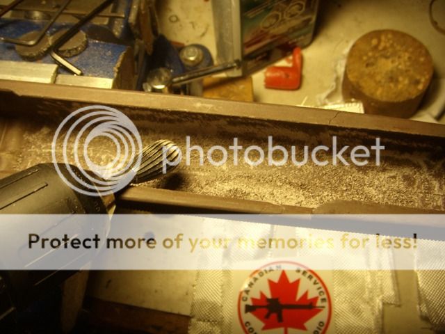

Start the process by scraping the factory paint and whatever clearcoats exist...

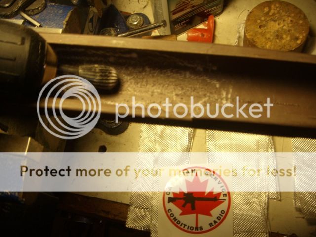

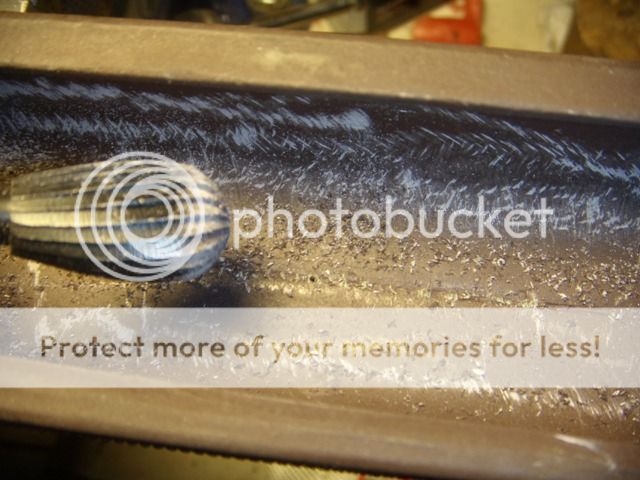

Keep on the scraping and cleaning for a superior bond with the resin:
At this point, I think I am almost done:

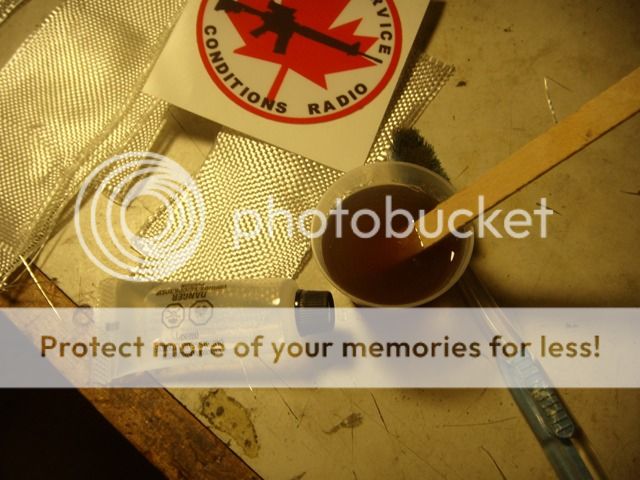

Measure/precut your 10 oz (Cambodian Tire or any auto supply shop) cloth so that it will fit inside the contour of your stock to be reinforced. Feel free to 'dry run' the laying down of the cloth before applying the sticky resin so that you are not in for any goofy surprises.
I used medicine cups or Lily brand waxed cups from my wife's bathroom for the mixing process. Steal all the used popsicle sticks you can from your kids after they complete their sweet desserts!
