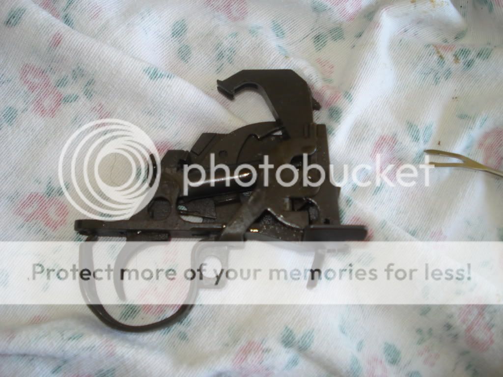

Sounds like the spring pin from the stripper clip guide is too far into the receiver...
Seen a few....few customers with bad scope mount(or stripper clip guides) instalation.if the pin portrude only alittle inside the receiver the hammer will hit it and cause a failure to fire...not even a light strike as you would see with a dirty gun. Simple no ?
