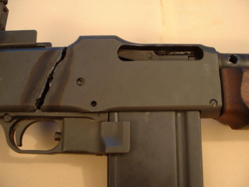

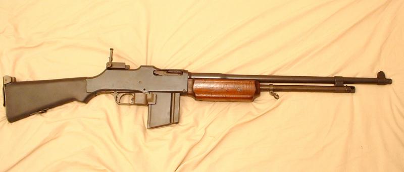

Heres mine before and after. As you can see some lunatic cut into the reciever to deact it as mentioned. A hole is on the barrel as is some kind of slice as well. But the gas tube is mint.

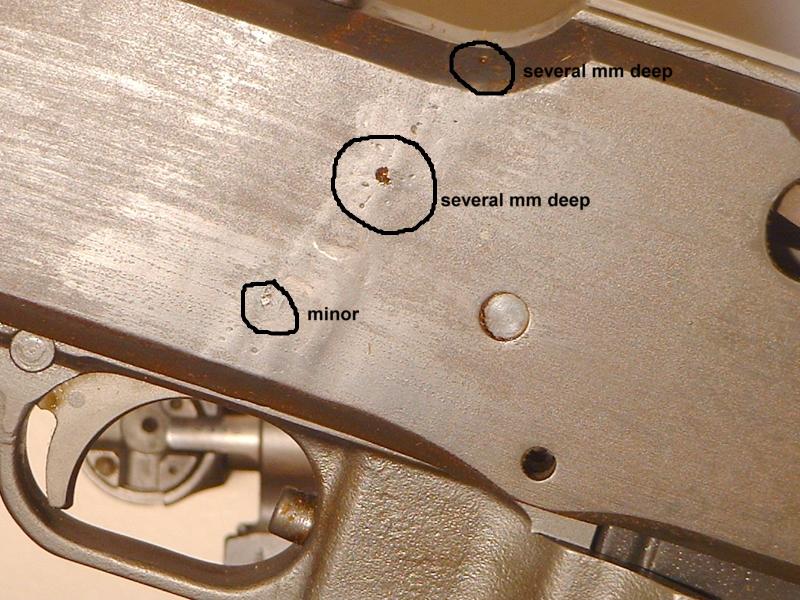

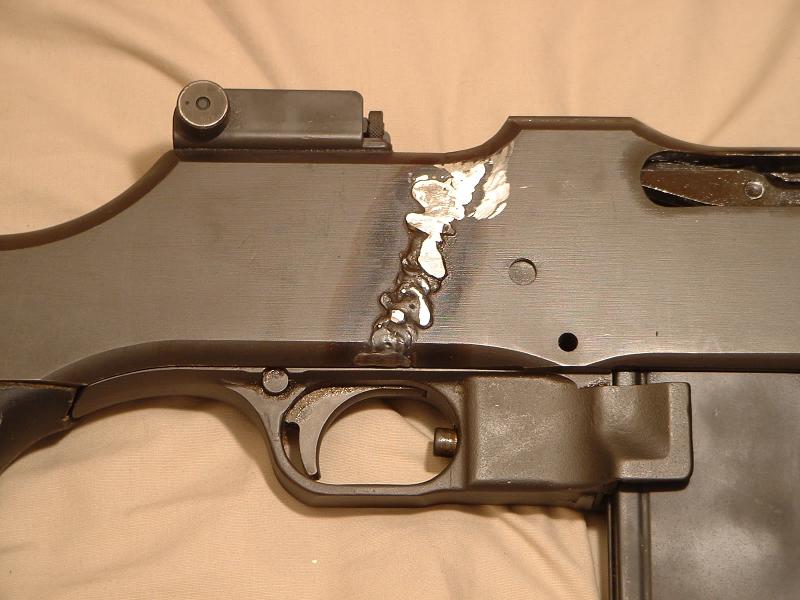

As you can see the welds were an issue as stated. First I used MIG. That was a big mistake. Too porous. Then finished it with TIG which fixed it as good as it will be for now. You can see the weld marks and it looks like a big snot mark on the side of the gun but Ive seen worse.

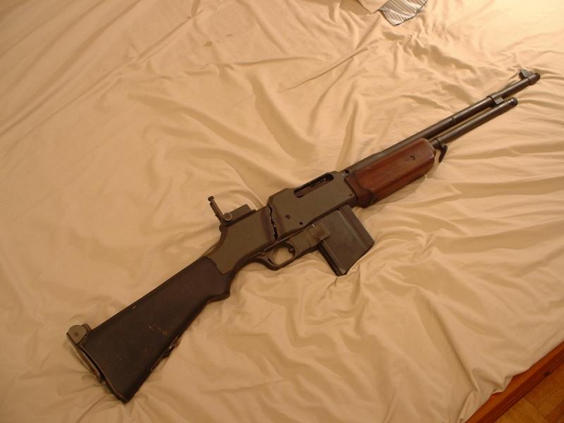

This is why when I display the gun at home or at the shows I show it this way
with the ####ty side in.

Did you try some small SMAW like 1/16" 7018? It would probably work great on that receiver and barrel. Still...slashed up or not I'd love to have that BAR! I'd be like Oprah Winfrey talking to a deformed child "Your beautiful, your beautiful I dont care what anyone says **tears in eyes*)

No but eventually I,m going to try it again. It looks ok actually now that I have blued it again. Just looks like some battle scars. The problem is the metal is so brittle to weld. Its like welding butter.
I only paid 350 bucks for it so I,m happy for now.
