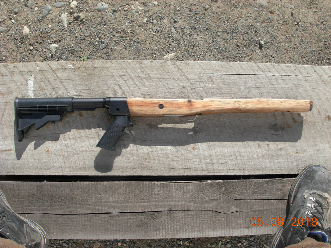

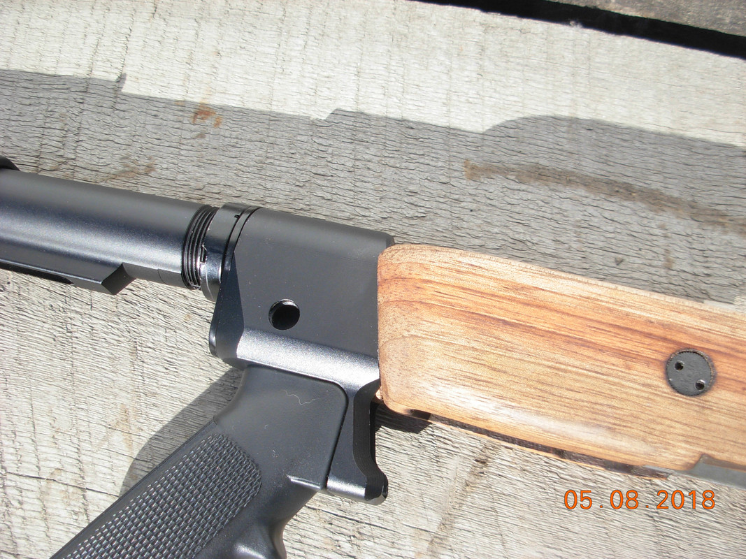

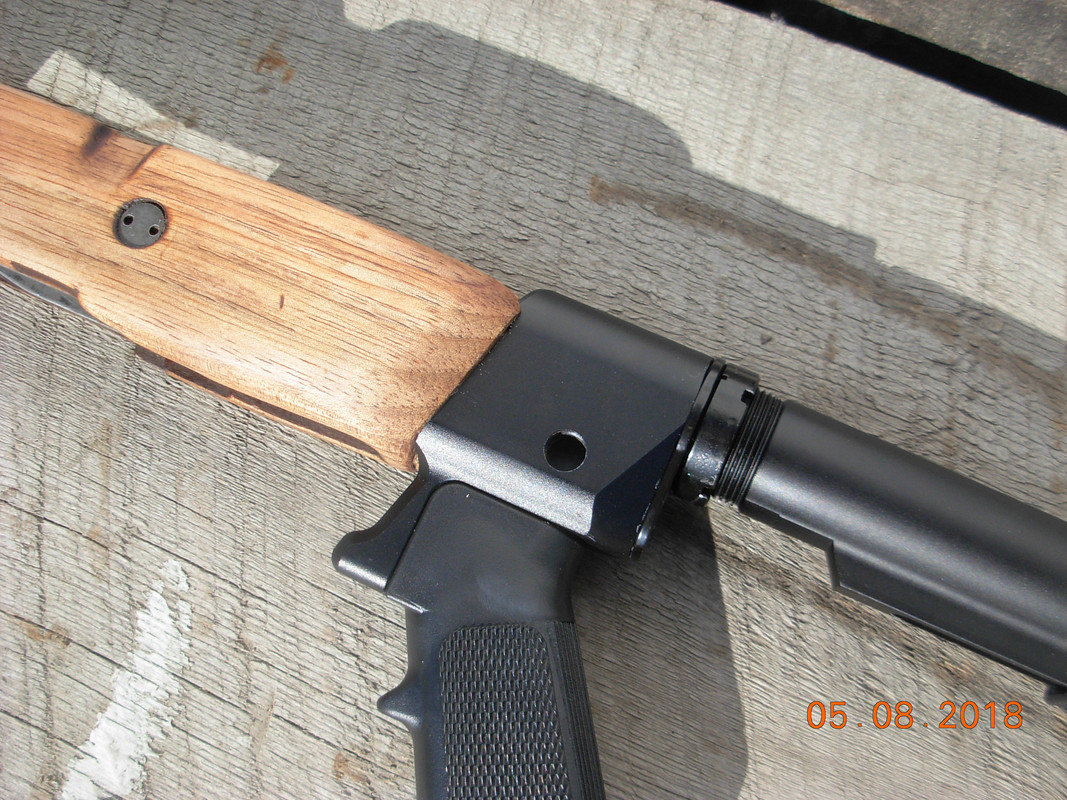

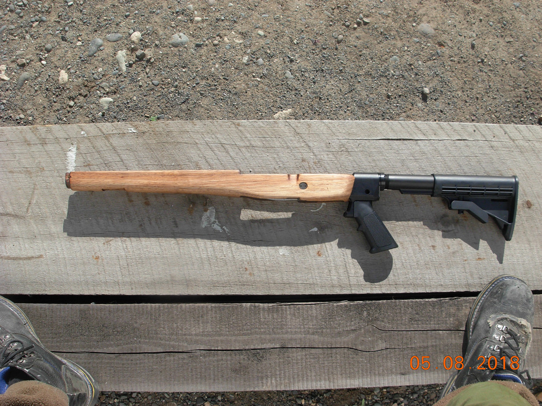

I picked up this stock/adaptor setup at the Kamloops gun show. It's Chu wood, I finished off the sanding, bleached it, then gave it a few coats of 100% tung oil, and steel wooled it between coats.
It's still a tad oily to the touch, I'm slowly working on that. It's about 10 ounces lighter than the black plastic Norinco stock.
That chu wood is unbelievably soft. I'll be looking for a different stock at some point, probably a Boyds. I'm still undecided on the AR stock, but even if I decide against it, I can always put it on my Grizzly.
