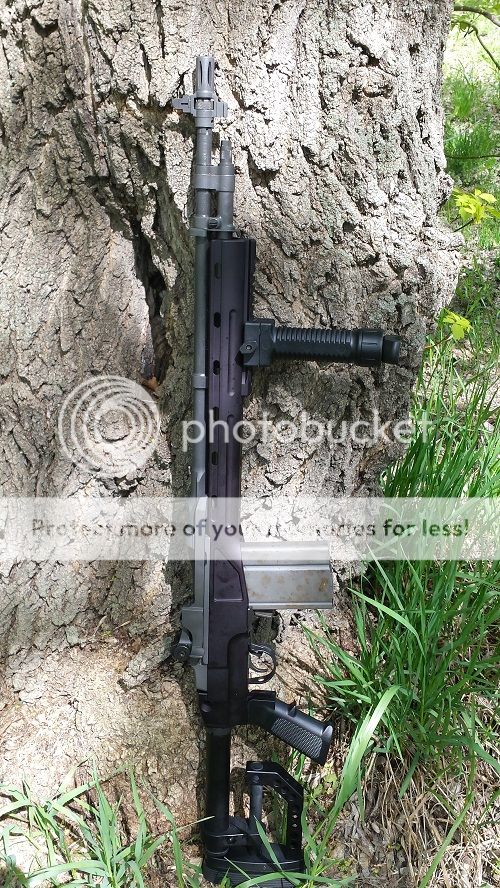

so I got my 305a from a dealer today and the first thing I did was see if it would function in a aftermarket stock...

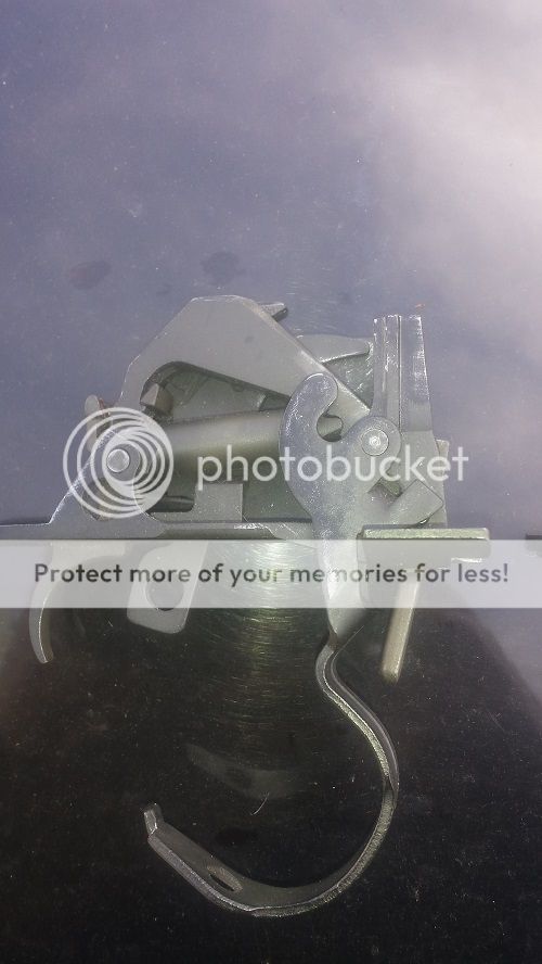

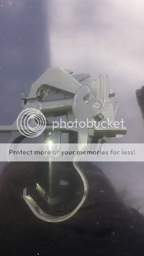

haven't tried the sage yet but the blackfeather seems to work fine but you need to replace the trigger group as the one that comes with the rifle has a small tab to stop the ak mags from seating too high and will not allow m14 mag to seat.

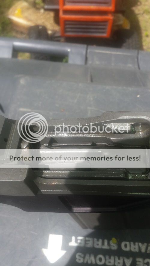

also that fixed ejector is getting old real quick as the bolt is almost impossible to get out because of it. The bolt has the port for the plunger ejector so I'm going to see if it will fit.
EDIT... and its staying while you can put a plunger in there it not drilled for the spring. that spring is dangerous!!!!!
