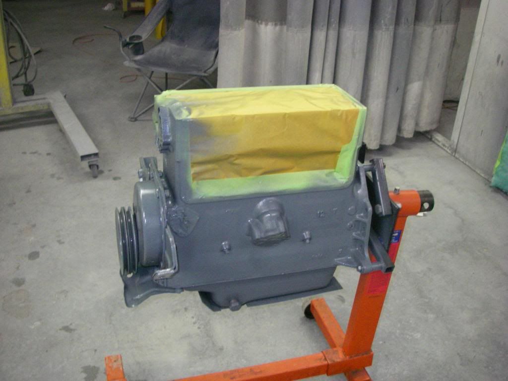

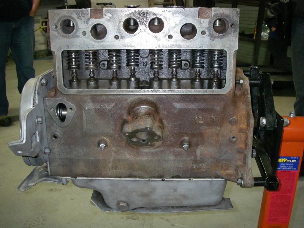

After being delayed for several weeks, I finally had a Saturday without snow needing to be plowed and was able to get the engine into paint.

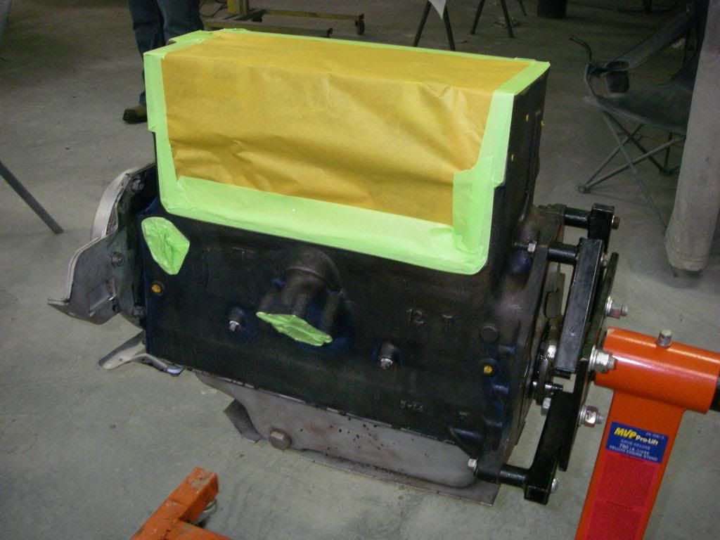

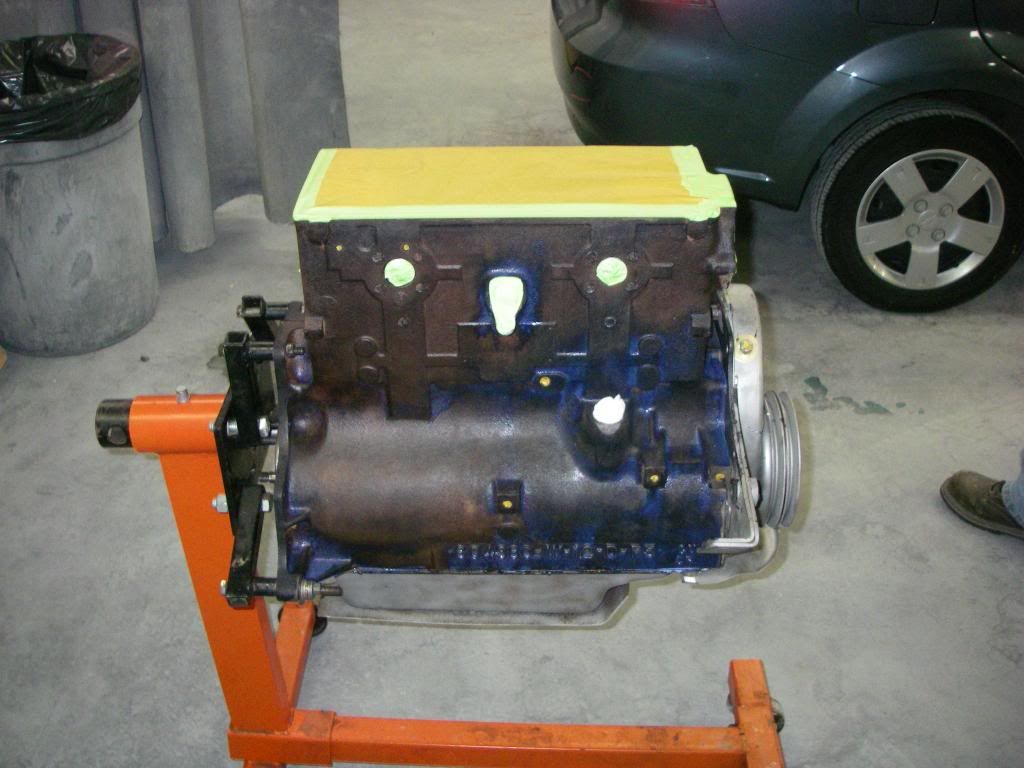

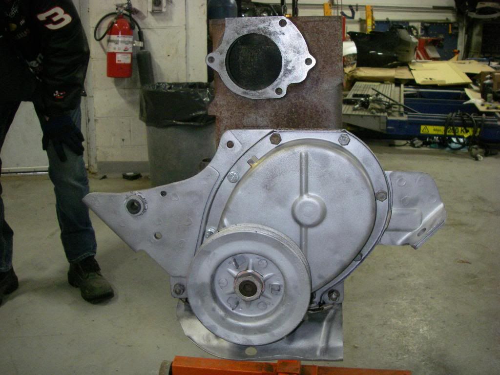

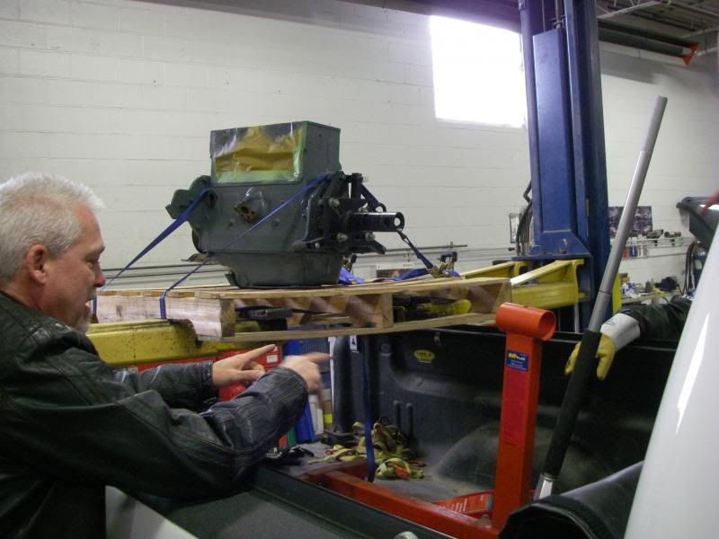

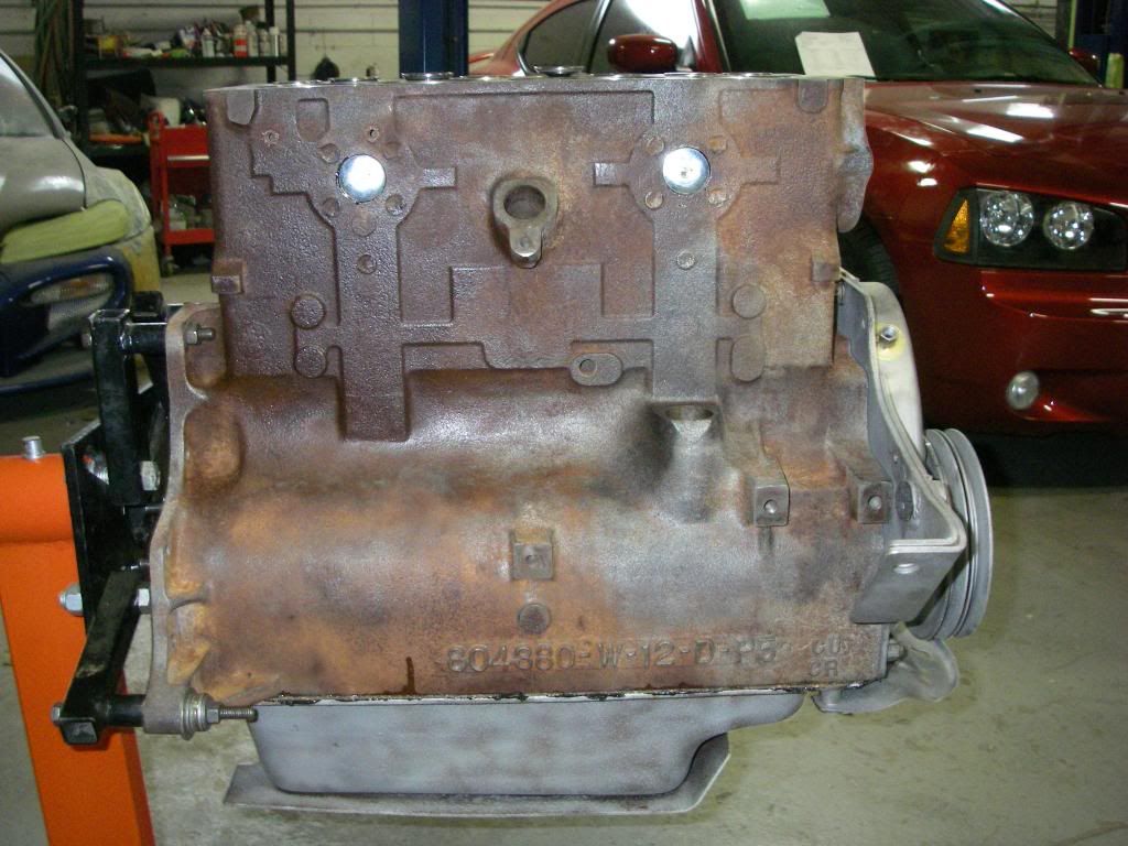

Getting the engine onto the stand, I was able to get a look at the full picture for the first time since getting it back from the engine shop.

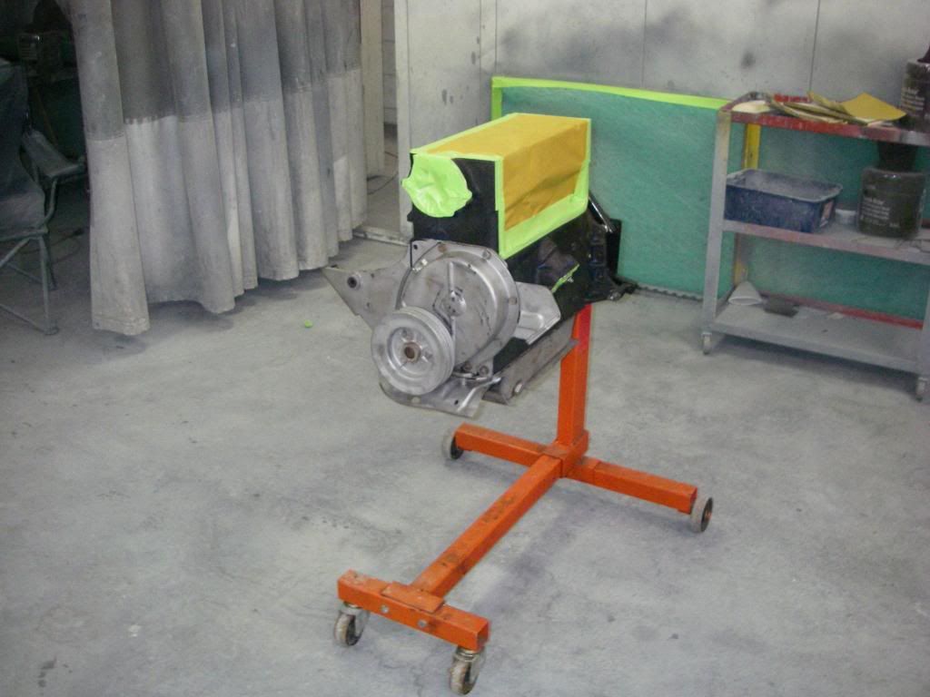

Rust converter applied and prep work completed.

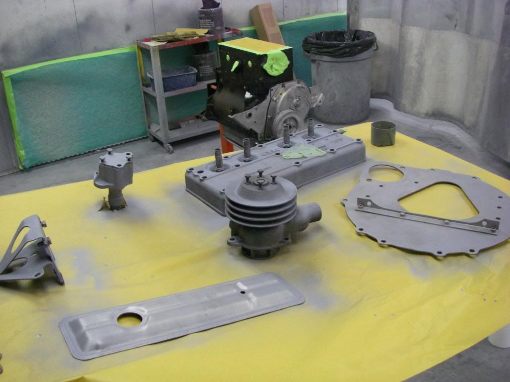

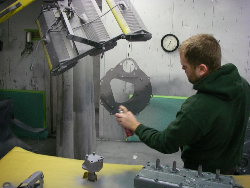

And into the booth!

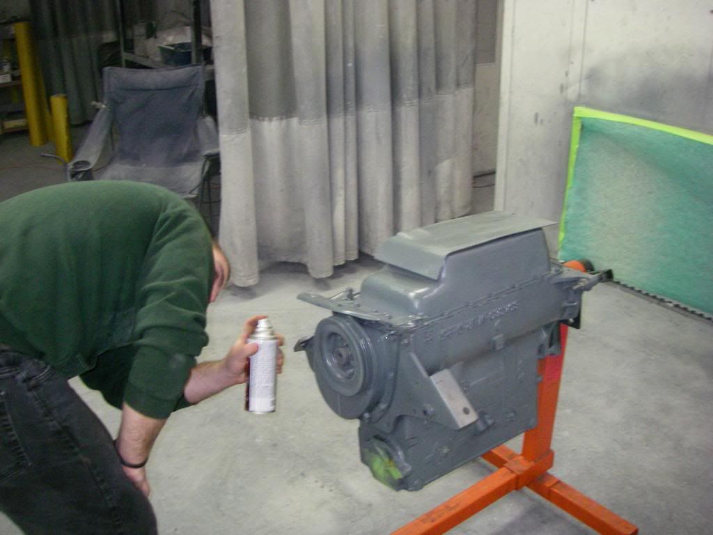

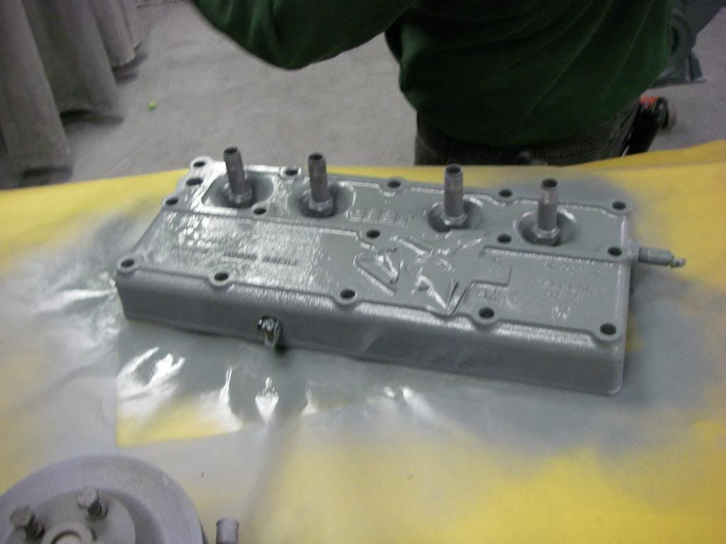

With etching primer applied to the various bits.

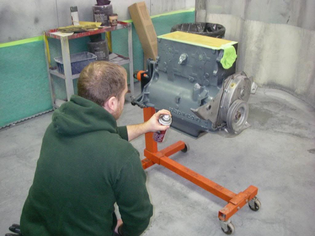

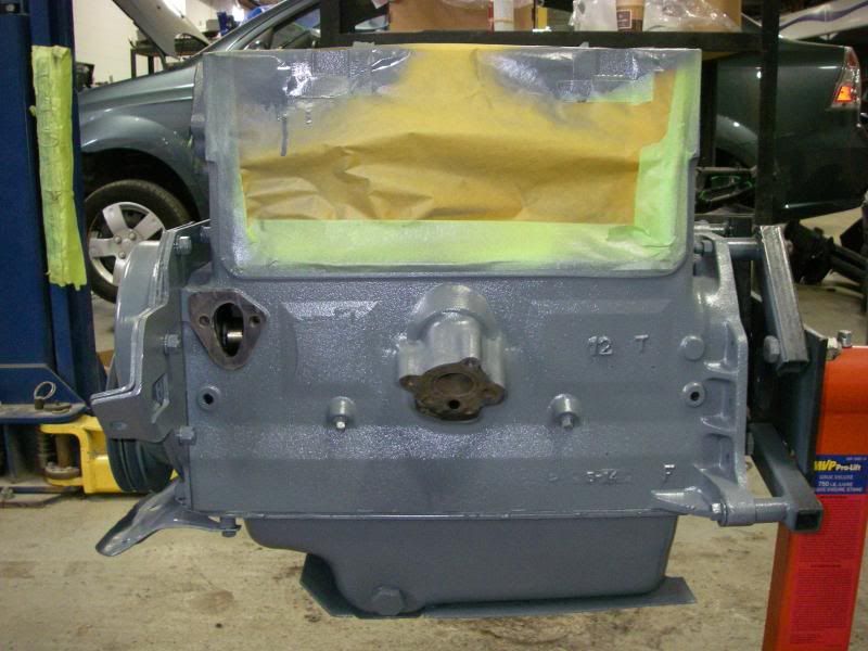

Begin paint!

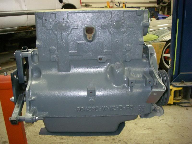

I chose to go with PlastiKote Engine Enamel in colour 202: Universal Gray, and I have been very pleased with the colour and results so far. Final product for the day:
