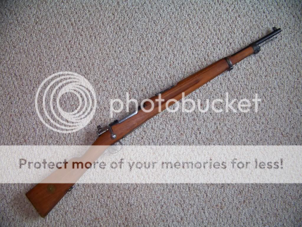

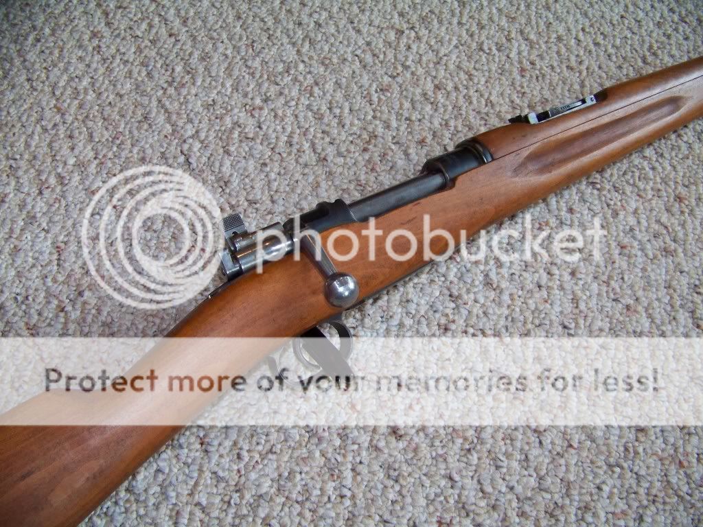

A couple of pics of the rifle in its dirty state:
Can anyone translate this stock disc?
I will post some better pics when it is clean and shiny again.
