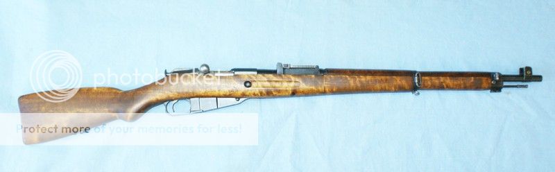

I retook an M39 family photo. Still not the best picture as I got lazy and used an iPhone 6 for a cameraI need to dig out one of my nicer cameras and do a better job with the lighting.
Top to bottom:
1) 1968 "no maker" (some people say "sneak). Unissued.
2) 1941 Sako straight stock variant. Definitely issued. It's been there, done that.
3) 1942 VKT. Possibly unissued, or if issued, it was not used much.
None of these are refurbs - just the way I like it.
