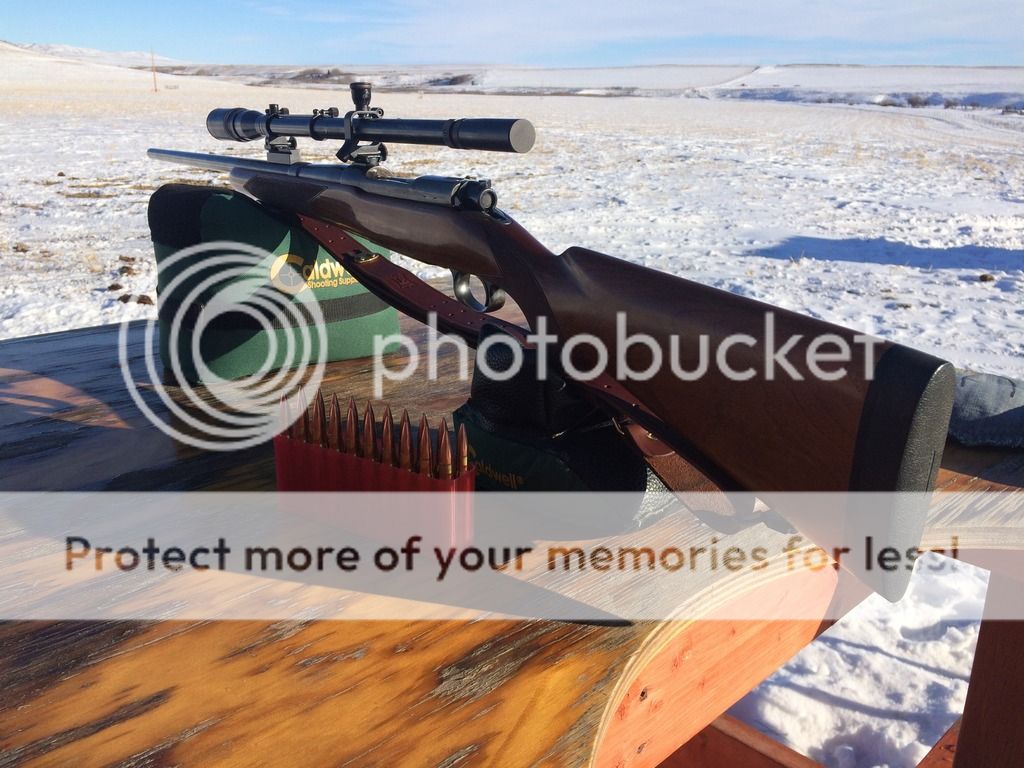

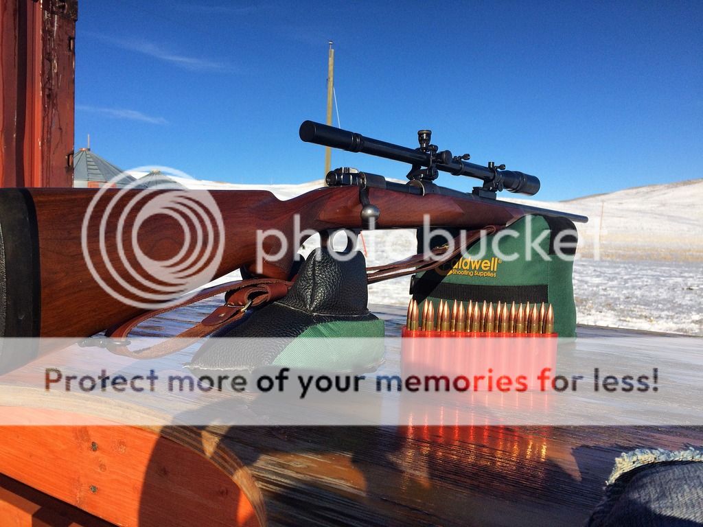

I just picked up a Model 70 Vietnam era sniper build about a month ago, a 1946 model 70 in 30-06 with a Hi-Lux USMC 8x scope.
Planning on re-barreling with the the original "heavy" taper.

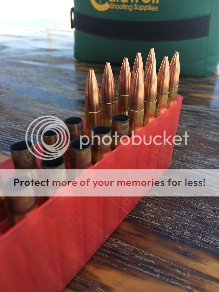

Something oddly satisfying to me about match grade 30-06, these are 200gr SMK's with Winchester brass, a staring load of IMR 4350 and cci
Got it zeroed and it would do pretty well for 4 shots, then throw the 5th. Not bad for a 71 year old Sporter weight barrel!
Most groups including the fliers where in the 0.8"-1.1" range at 100 yards. Have a lad test of 200SMK and 200 ELD-X ready to test, just need some warmer weather.
