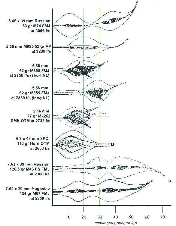

I know the source might not be everyone's favourite, but here is an interesting link with some info for anyone who hasn't seen it before. (take out the big space after "http", the word "ammo" and before the word "project" and paste it in your browser)
http ://ammo .ar15.com/ project/Self_Defense_Ammo_FAQ/index.htm#.223
http://www.bajaarizona.org/fklr/fklr.html
Not everything that may apply, but reading the above will give you a far better understanding of what happens downrange.
NS
Fackler published all the studies on fragmentation and velocity in the late 80's.
SS109 bullets and the original 55grs were engineered much earlier. The SS109 is a product of the late 70's by FN.
So let's stop putting 1 + 1 =3 : that "5.56 is engineered to fragment at 2700 fps" because it is not. They just figured that out after the fact. From what I gathered, they did do ballistic gel testing on SS109 in the early 80's when they were testing the M16A2. However, the mechanism was not studied and published until Fackler came abroad.
Wasn't one of the design criteria of the M855 a requirement to pierce steel helmets at 400 yards? I could have sworn I read that, but now I can't find it. Anyone clarify?
Interesting graph/pictures ... One does wonder at what kind of a range a typical 5.56 bullet would have slowed down below the 2000fps range (at which point it ceases to fragment and as such would lose much of it's effectiveness). It would also have been interesting to see gelatin-block tests performed at a full range of velocities to see how it affects the wound cavity and behavior of a projectile at impact.
