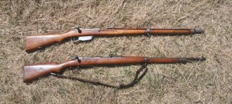

“Premature firing?”…there’s a pill for that.Just got a really nice steyr m95 straight pull rifle. When I took it shooting it fired while I was cocking it twice. Wondering if anyone else has come across a similar problem with theirs and what possible solutions are. The rifle in question at the top. View attachment 948098

Yes as the bolt was pushed forward it fired.Do you mean it fired as you pushed the bolt home?
If so - I have seen this a number of times on various milsurps over the years.
It could be a few things, weak trigger / sear spring (allowing it to drop below normal operating height), worn sear, or worn sear engagement surface on the bolt / cocking piece, etc.
Any of those would allow the bolt to close and simultaneously allow the firing pin to follow.
It would likely be enough to set off a commercial primer, especially PPU.
