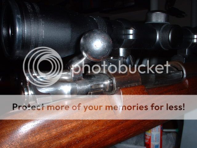

Try this link, second entry for 93-96 mausers, I use one and it works well, http://www.daytraco.com/search_result.asp
Product ID : DMS93 Category Manufacturer
MK II Safety Dayton Traister
Mark II Safety M93 96 Mauser
Made from AISI 4140 chrome moly steel, it is one piece, hardened and tempered. It comes with a nylon friction piece inserted to eliminate rattling and ensure smooth operation. This is a true striker blocking safety - superior to trigger blocking and sear blocking safeties.
