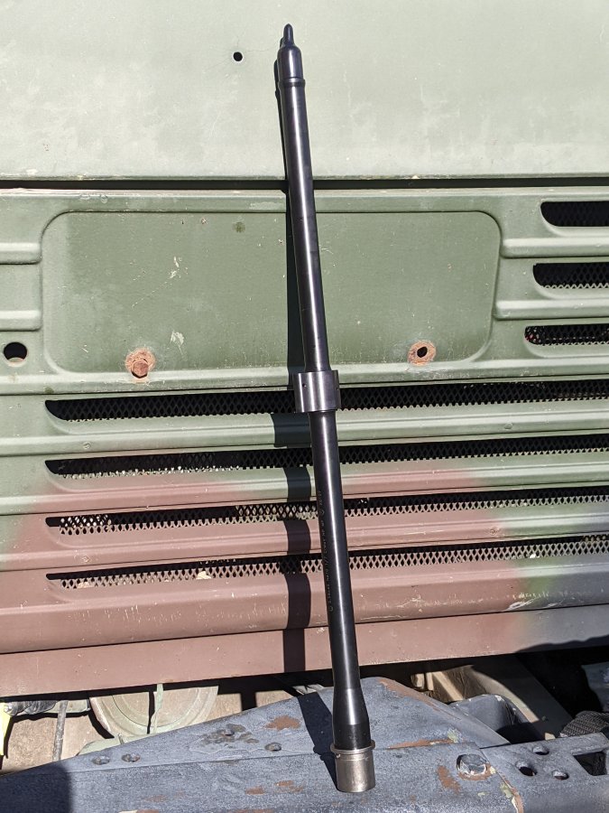

Made for Canada, Ballisitic Advantage18.6 Hanson profile 5.56 Barrel for your Raven or Crypto build

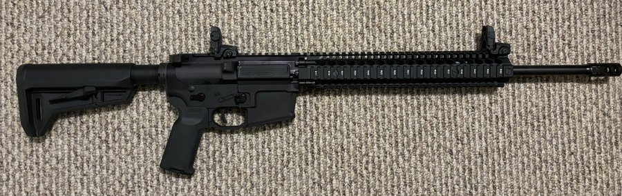

This is a Crypto build we did a couple weeks ago with the Hanson barrel, Aero S-Handguard and Black Cherry Cerakote.
