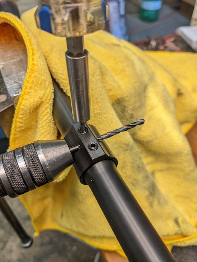

Had customer have a few issues pinning his gas block this past weekend, so thought I would pass on a couple tips to prevent issues.

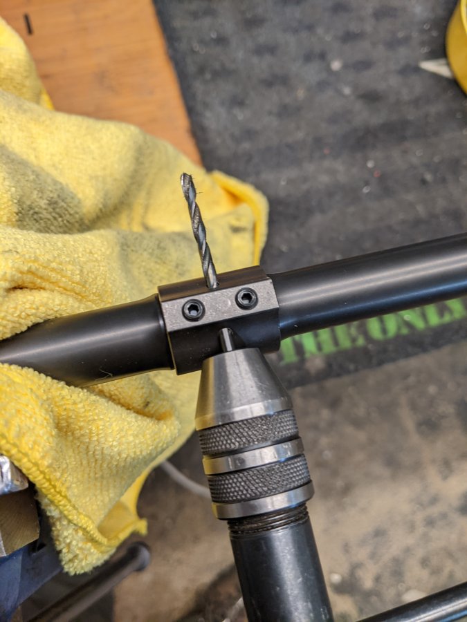

First, line up the gas block by manually inserting a 1/8 drill bit (vicegrips to hold drill bit works well) work it far enough that the shaft of drill bit is in the groove for pin.

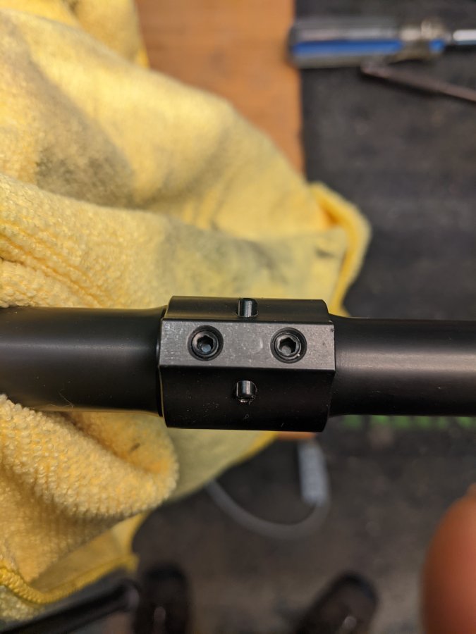

After you have block nicely lined up and held in place with drill bit, tighten set screws well, these will hold gas block in place when installing gas block pin.
Lastly, if you have a pin starter that works best, if not just take your time with a punch, and always try and hammer towards yourself, you will have more control that way.
Easy peezy, few taps and your done.
Will these set screws work themselves loose overtime? Should I blue locktite them?
