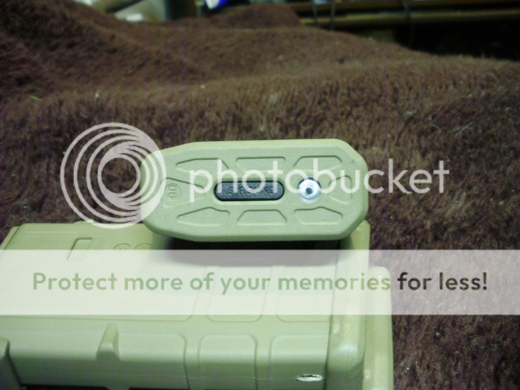

Magpul 5 Round limiter installed, some of the 20 round Pmags already have the hole for the pop rivet in the floor plate.
Unfortunatly you can't use Ranger Floor plates with the rivet.
