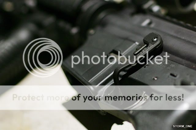

The BAD lever makes this easier as you can lock the bolt to the rear using the lever so you don't take your hand off fire control. It is also faster.
