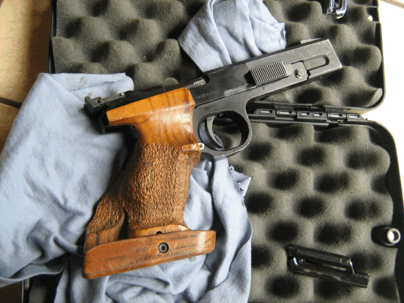

:D Just got it in the mail. I am still in fondling stage, never fired this thing yet. Cycled dummies but cannot make it to the range. Old owner will probably recognize his toy.
