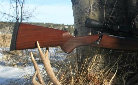

Not really sure I'm even using the correct terminology,I'm hoping some of you guys will give me some input on caring for the stock on my Kimber.
Most of my hunting rifles are synthetic stocked, the other ones like my Model Seven CDL or the Marlins have a coating like varathane or something, I think they are sealed or varnished, but the Kimber is definitely not. I just don't have much experience with wood in general.
My Kimber never sees bad weather, but I want to make sure the stock doesn't dry out or crack on me. Obviously it's not the fanciest piece of lumber out there, but this is my favourite rifle and one of the things that appeal to me about this particular stock is that it is just dull or matte in appearance, I believe Kimber advertises it as a "hand-rubbed oil finish" or something.
What should I use to preserve the original look? How should I apply it?
This rifle will be handed down to my son, and I just want to know I did my part to make it last.
