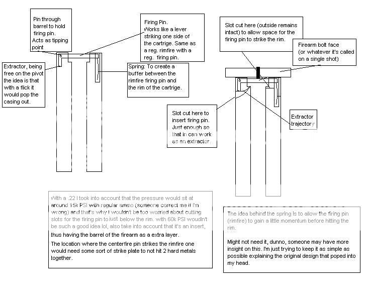

I've got a really good idea that would create a firing pin that would allow the insert to be centered as well as a extractor no matter how recessed the base of the case is. It's a little complicated tho. If anyone is curious I can make an attempt at explain it, or try and draw pictures somehow.
lucky07 - If you have a scanner, you could sketch your idea, and post the sketch.
Using a little plug insert to allow a centerfire firing pin to fire a rimfire cartridge in an adapter is common. With an O-ring, it won't fall out and get lost. Downside to this sort of insert is that it makes the adapter all that much slower to reload. I have a .22/.223 inset like this. Also have a .32ACP/.308 insert. The .32 primer is struck by the cf firing pin.
The insert barrels used in quality European arms have the chamber offset, The extra room created by the offset chamber is used to install an extractor which is engaged by the centerfire extractor. These inserts are indexed, and lock in place, so zeroing is not an ongoing struggle.
Obviously my distances and such aren't that great ... MS Paint isn't exactly known for it's precision. lol
Just thought of another good way but it's a helluvalot more complicated.
