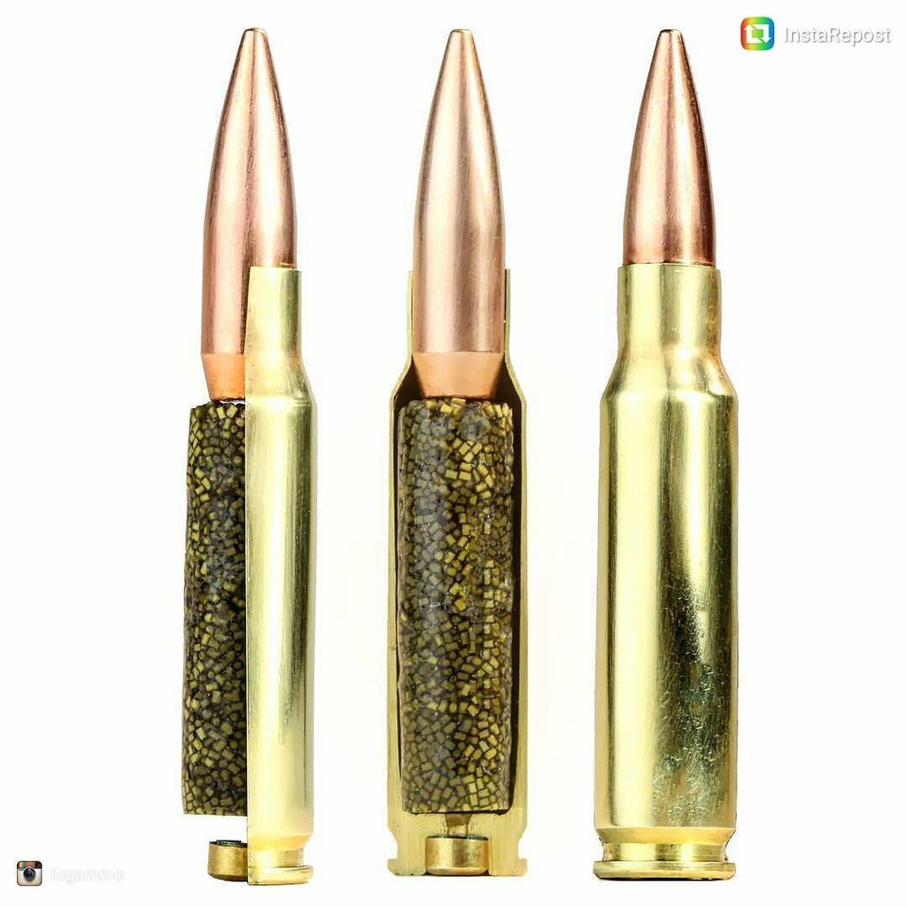

Perhaps try loading and shooting some loads in brass prepped like this - fired-deprimed-tumbled-collet sized-loaded - and see if the seating pressure is more consistent. Doing this will certainly identify if the turning step is creating the issue
If you get better results seating, but groups are the same, then personally i would seat to 2.80 and try again - this will put the boattail/bearing surface junction slightly above the bottom of the neck - me thinks right now you are below the neck - if no change, try another bullet. Personally i am on the fence thinking this makes a bigger difference than chasing lands WITH THIS BULLET ONLY... my 5R, Sig3000, and Sav LRPV 12 all shot worse when chasing lands using a 175 SMK - load to 2.8ish COAL and the bugholes appeared. I want to say, from memory (may be wrong!lol!) that the ogive measurement was 2.09 using a Sinclair tool.
Here is a nice pic of a 168 smk at the optimal spot:
https://pbs.twimg.com/media/DIGrgLLWsAQJe7t.jpg
I realize your rifle may not allow this due to a short throat, but if it can, try it. When i did this, it took a lot of demons out of my "search for the perfect load" trials with that particular bullet.
You may be at the peak of what this particular barrel / bullet combo can do, but hopefully not.
Again, try some 168 Hybrids before you get set on a load...it may make you say WOW

The challenge sure is addictive!
I can confirm, at 2.735'', the boat tail is under the neck.
if i should load let's say 2.800'', chamber, extract, it will come back out seated back almost up to 2.750''.
Which is why i think hornady match bthp 178gr we're good for me at the start. With it's Ogive, i was touching lands at 2.805'' and was loading at 2.800'' with it.
SMKs act differently
