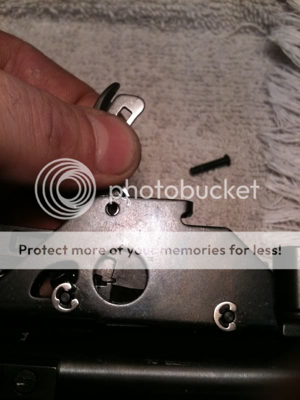

I got mine down to 13 oz using the cut the coil trick. you just have to bend a point at the top to fit in the locator hole. here are some pics i took. It's like one "E" clip, one pin, snip snip... bob's your uncle. I kept mine at 1 pound, but it adjusted from about 13 oz - 2 pounds.
