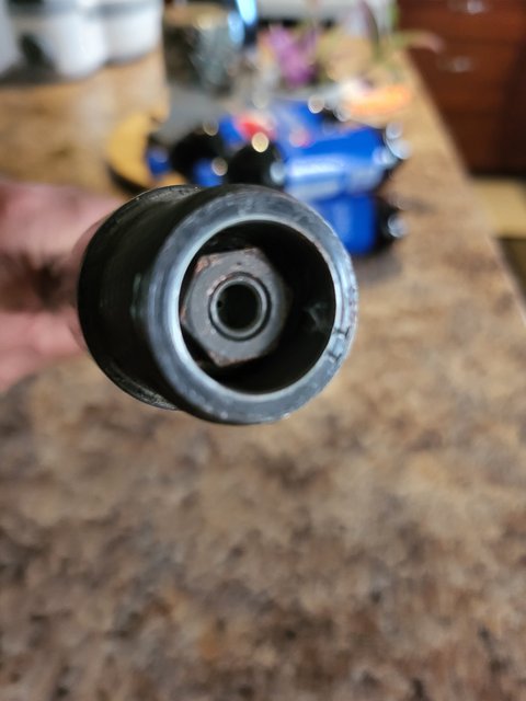

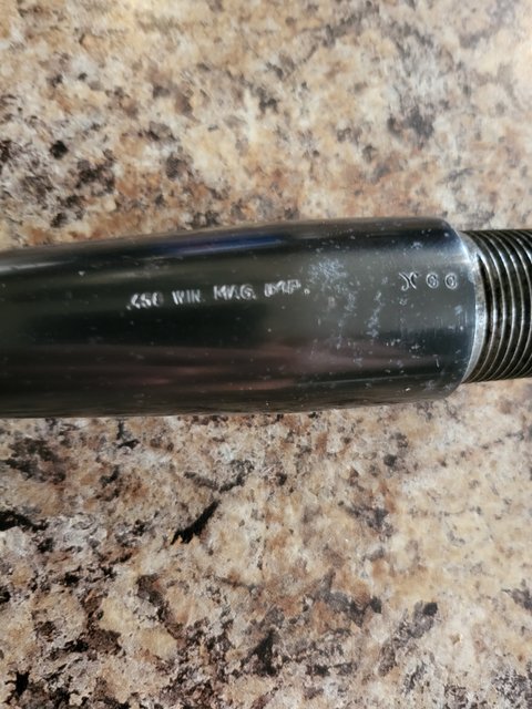

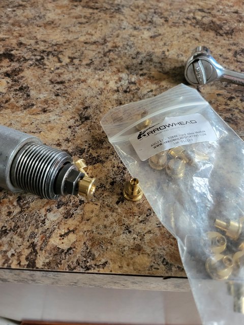

This is a project done on the cheap but performance should still be outstanding. The barrel started out as a 458 rem 700 winmag. Looks like rechambered to an improved at some point. I bought it on the ee a couple years ago with this project in mind.

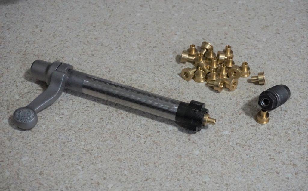

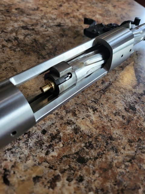

I went with the arrowhead sporting goods LRMP system since I already have primer modules and it is a top notch plug that uses a standard 700 bolt with no mods.
Machining for the plug was the only real work, the old chamber will act as a bit of a powder chamber to shorten the powder column up. Was close but I have enough powder volume in my loads that I didn't need to worry about setting the shoulder back to remove any of the .458 improved chamber.

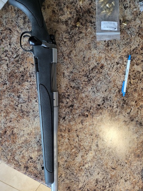

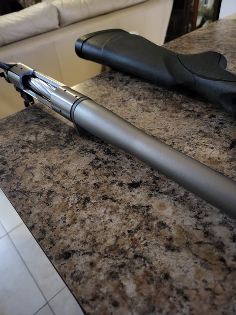

She got a brand new 700 action and ptg bolt just because I had it on hand with no future long action projects in mind.
Tupperware stock I had in my parts bin...probably pull the guts from mag and store extra rounds in it.
Only paint left.
I have about 800-900 $ in it and 3-4 hours of work. If it shoots well I'll spring for a Boyd's stock, if not she will be a 75 yard gun for one weekend a year when we have ml deer hunting and I am off work with a tag left over from rifle.
I will shoot naked .452 tmz bullets smooth formed over 4198

Yep...close to performance of magnum centerfire. I have an adjustable sizing die to fine tune the fit of the bullet to bore
Crazy weird, i dont really get it---- does the bolt stay closed alwys?
firing pin hits the cap at the end of bolt? cap fires powder?
:D
im from australia... haha. that might explain the WTF of my post Qs
The brass modules get primed with magnum primers. It is the shape of the base of a .308 cartridge. The tip of the module goes into the breech plug when the bolt is closed and then ignition is sealed by the brass module. Hope that makes sense?
You change modules when you reload.
