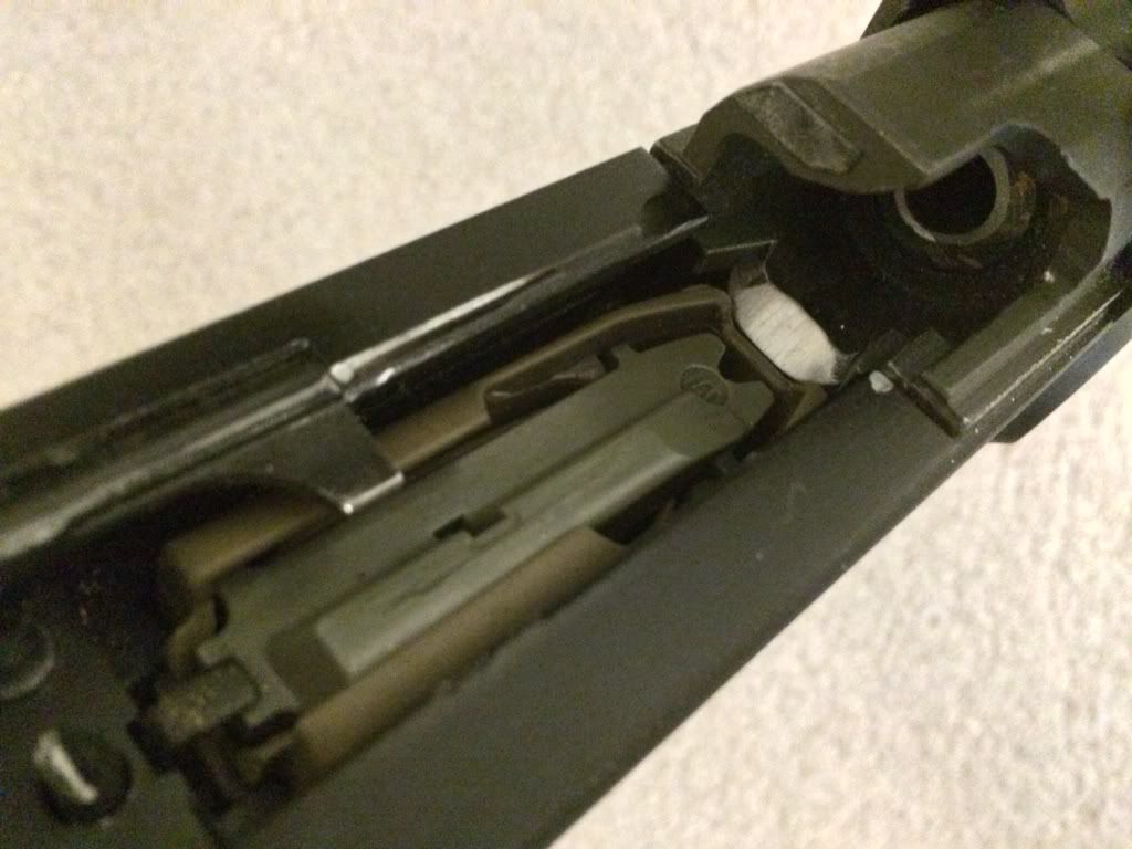

Bevelling the feed ramp so that the feeding cartridge directs towards the hole also helps the feeding.
This T97 now feeds from PMAG 100% reliably at any angle(Pushing the mag up, down, sideways etc etc)
Also feeds perfectly with LAR-15 10 Rounders.
Here's what it looks like with a Pmag inserted
it looks like you beveled the chamber a little too. ive also done your ramp mod and it feeds 99.9% reliably now, but every once in a while ill get a bullet that hits just outside the chamber edge while feeding and get stuck, i was thinking about beveling it a bit but wasnt sure if it would be dangerous to do so

i used a dremel with the largest diameter grinding stone that would fit without hitting the walls, and went in through the bottom of the magwell with it. t_102's instructions were pretty clear i thought.
I apparently received a t97 with the ftf issues from new ( pushed in bullets , sideways rounds rammed into breech ), not with the factory mag but with grey and also the black lar-15 mags. I wanted the 10 round capacity so it was huge issue and a deal breaker if I could not use the lar-15 mags. I read every article I could find on the net re: magazine mods, feed ramp mods, ramp polishing..... I stated with the easiest step first by highly polishing my feed ramp and no luck whatsoever. I then looked at the magazines and after close examination it just seemed better to mod my rifle so that it would feed properly with all magazines. I started by filing the notches where the tip of the bullet would impact the ramp but found only a mild improvement and I still found myself frustrated at the range with unpredictable jambs and gun powder everywhere in the action. I finally realized that t_102's method was going to wok the best ( attempted partial filing of the feed ramp and it looked good but did not work , still had ftf issues) and I went the entire way filing tons of meat of the ramp into a nice clean U shape. Now my T97 will eat any brand of ammo that I feed it and feeds the grey and black lar-15 mags flawlessly. I am not happy that I had these initial problems but now that its working perfectly I really like this little rifle. Mine came with the FTU installed new from the store so I never had a chance to shoot it without a scope. I have a 1.25-4 Bushnell elite scope with the illuminated reticle on it and have dialled in a 2 inch group average from 100 yards, not great but good enough for a fun gun and that s hat I wanted it for fun, fun , fun. It was not the worst thing in the world having to figure out the ftf issue since I think I ending up adding something to basically every rifle I own, ( usually a new or modified trigger group, barrel brace, glass bedding, firing pin spring, sometimes a stock, or even a heavy barrel). I just wanted to share my experience since I was hesitant to actually file that much material ( yes its quite a bit ) out of the feed ramp on a new rifle. It was really worth it and even though its not an expensive gun its one of my favourites now, a huge fun factor and reasonable groups. It also looks like the aftermarket support is going to produce some really nice additions to this rifle. Thanks again to t_102 for taking the chance on his rifle to figure this out, the 5 shot pinned factory mag would have made me just stick with my mini 30.
