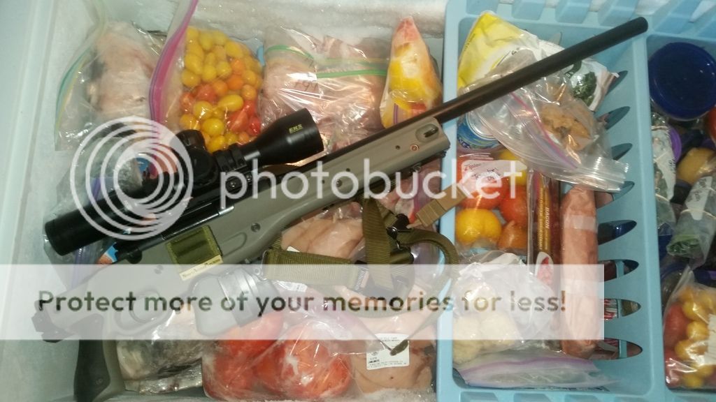

I saw a design online for a way to make your own IOTA. For those of you that don't know what that is it's a cover that goes over your objective lens that allows you to focus a scope well below the minimum focus distance, around 11'.
The one I saw just said to cut a circle of plastic to fit over your objective lens then cut a hole in it 1/3 the diameter of the cover. For a 2" lens you should cut a 0.66" hole for example.
I tried it and it worked a bit. Is this something you can do at home? I feel it's only working half as well as it should. One of the ones you can buy has a lens of some sort in the cover.
On a side note when I tried spinning off my sun shield to try this I was actually spinning off my objective lens! I think I almost spun it right off before I realized the sunshade was stuck. I hope I didn't damage anything or let moisture in.
