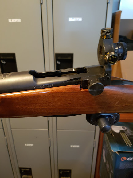

Does anyone know What the H and T on the turret mean? I think the H means UP?

Any advice on the turret will be appreciated.

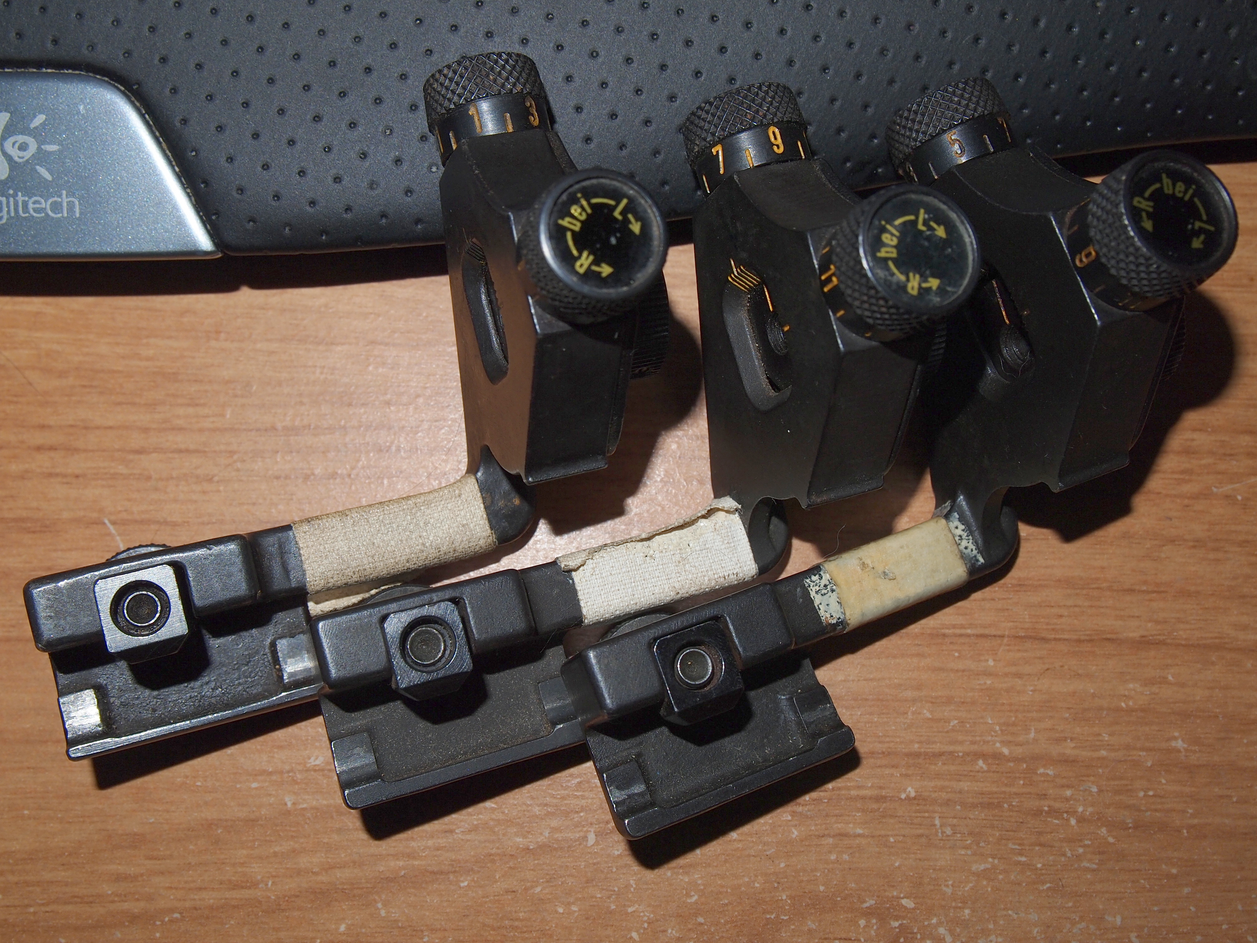

Note that in German target sights(iron adjustable peep) most have 'bei" on the knobs.
This means they correct BY where the Shot WAS. EG : shot(s) high high at 12 o'clock are corrected by moving knob in H (Hoche/High) direction.

My turrets don't have "bei" marked on them. I am shooting HIGH. I assume I should turn the turret in the "T" direction?
