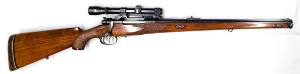

I thought you folks my enjoy seeing this... I know I'd be curious as to the "why"...
A customised 6.5mm 'M1908' Mannlicher Schöenauer Stutzen by Steyr, no. 21489​
Rotary-magazine, displaced and rebuilt trigger with pistolgrip, with replacement double rolled-edged triggerguard with foliate-scroll engraving, figured stock with inserts, wood extension and recoil-pad, the forestock fully stocked to the muzzle with pronged bi-pod type attachment, sling-eyes, the barrel with open-sights and ramp-mounted bead-foresight, the receiver with mounts for a telescope-sight
Weight 8lb. 9¼oz., 18½in. pull, 18¾in. barrel, nitro proof
There were numerous firearms altered for avid hunter Kaiser Wilhelm II to compensate for his disfigured left arm. I know of none quite as radical as this, but it may be in the same category.
