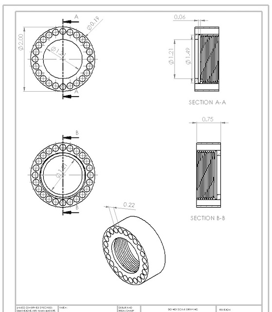

Armalite manufactured AR-10's, including the "(T)", and SuperSASS (Semi-Automatic Sniper System), will NOT WORK with the MRA Maverick Kit for the following reason:
The Armalite Barrel Nut Thread Pattern is different from the one used on the MRA Maverick Upper Receiver.
MRA based their .308Win./7.62mm "Maverick" Receiver on the DPMS manufactured Upper Receiver...
DPMS, Knight's Armament (KAC SR-25), and the MRA Maverick Kit, use a 1-7/16"x16 TPI (threads per inch),
Armalite and Noveske use a 1-7/16"x18 TPI for their Barrel Nuts.
Based on the AR-10 Barrel Nut drawing shown below, and having an actual AR-10 Barrel Nut as the "control" pattern, I was able to have a master machinist friend of mine make an exact copy of the Armalite AR-10 Barrel Nut, but with the MRA Maverick/DPMS 1-7/16"x16 TPI. Because of the intricacy of the nut's multiple hole and thread patterns, it took him 5 hours to reproduce.
The end result, I was able to assemble my Armalite AR-10 SuperSASS on the Maverick Kit.

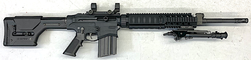

The bonus for converting an Armalite AR-10 to the MRA Maverick Kit is that you can now use the more common DPMS, Knight's Armament, Lancer, MagPul PMAG, and Larue .308Win magazines, as opposed to the proprietary AR-10 modified M-14 style magazines - which WILL NOT work with the MRA Maverick system.

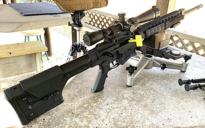

With Federal 168gr BTHP Match, it will group 1" - 1-1/4" at 100yds.
Pics of the assembled Maverick "AR-10 SuperSASS" are below.
