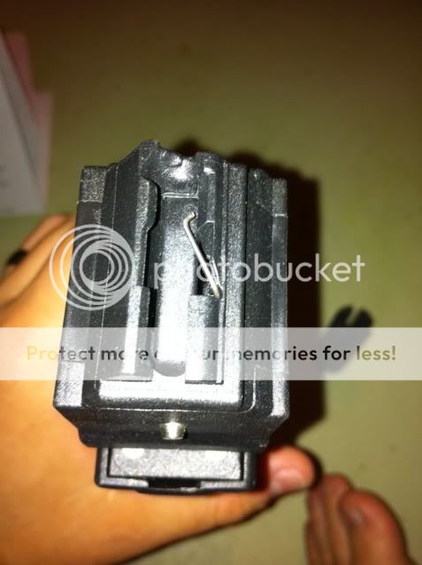

PPS. I also have that weird spring/thingie on top of the magazine. :confused:
PPPS. (re: PPS) It's a feature of the magazine, designed to control the feeding process when your 10/22 inserts the cartridge into the barrel! Here's a video that explains it (in part): http://www.youtube.com/watch?v=pnGHiwRn2iQ
i definitely have a feed issue with my mag....with the factory 10 rnd or butler creek mag..it would feed no problem....but with the supplied mag...it wont feed at all.
i figure it out....with that little spring on the feed lip...it would not let the round get enough upward angle to enter the chamber. Now with that spring gone, it feeds!
edited: went to the range today. Had a whole bunch of people gather around me! The AA921 mag will not feed. It looks like it does not have enough upward angle on the feed lip to guide the round into the chamber. It would hit just below the chamber. With the springs out, it definitely is a little better allow the round to get more angle but still won't feed. I have fiddle around with it for more than 3 hrs now,if anyone in the lower mainland have a mag that works, i want to meet up with you and try yours!

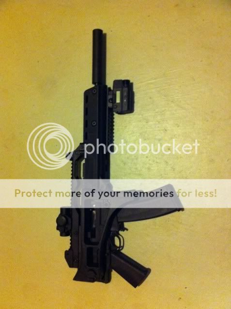

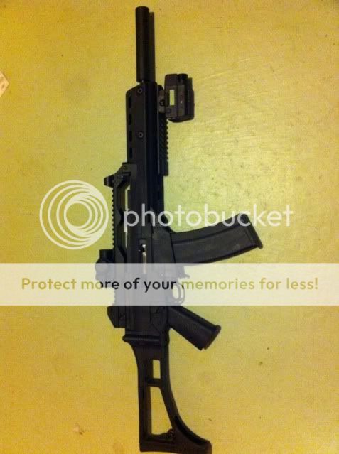

Here are a few pics of mine, I included a pic of the mystery spring in the mag, it's all good it's supposed to be like that, apparently....
