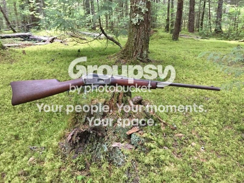

Here's the ole girl in her "natural habitat":

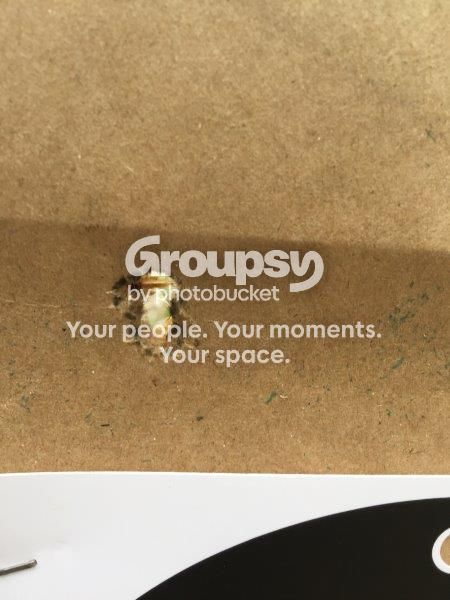

Well, the groups speak for themselves and surprised me, pleasantly. First three shots of a rest went into a cloverleaf; high and left is all my hold; a heavier boolit; and just generally load development:

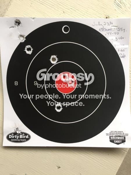

Next, I tried 10 shots offhand (and I'm not that steady this morning); the missing 3 were entirely my fault:
Plenty good enough for me! Now I just have to work out the feeding since it has some of the typical Marlin "pickiness" when it comes to feeding. I've had my share of working out Marlin feeding issues so I'll get there (and on that note, I've got a late model pre"Remlin" with ALL the complaints folks attribute to Remington... I'm of the opinion Remington got the short end of the stick and that Marlin's quality was declining first. But anyway that's another topic...).
Anyway, thought folks might be interested. As others have stated before on this forum (and also in my own experience), a pitted bore does not necessarily mean an inaccurate or unshootable gun. Slug that bore and try different loads, including boolits.
