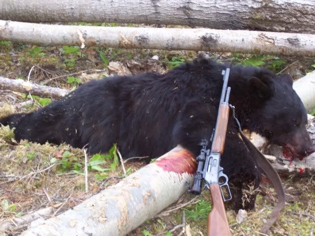

i sure love my 45-70 GG!!:cool: .....it's my only go to gun now!!:D ...i have had mine for about 3 years now and has never let me down!.....i shoot 550 hard cast "crater" bullets using 40 grains of h322(1530fps)from my beast ....here's a 6'2" blacky i shot about 5 days ago!.....larry:)
Yes I have they average 1580fps to 1600fps. :cool:
I stopped at that velocity because that's roughly where Garret stopped on his factory loads. I had absolutely no pressure signs of any kind and have shot about 150 of them now.
I find the felt recoil is less with the 550gr bullets @ 1600fps than 400gr bullets @ 1950fps.
That's a nice looking bear. Congrates......
