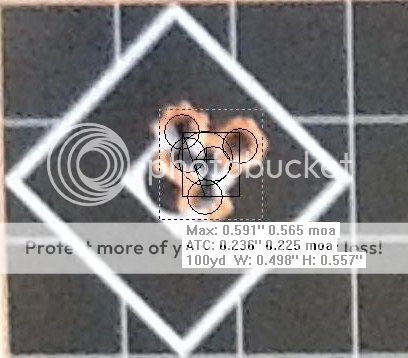

That is outstanding shooting, hope you get more like that.
