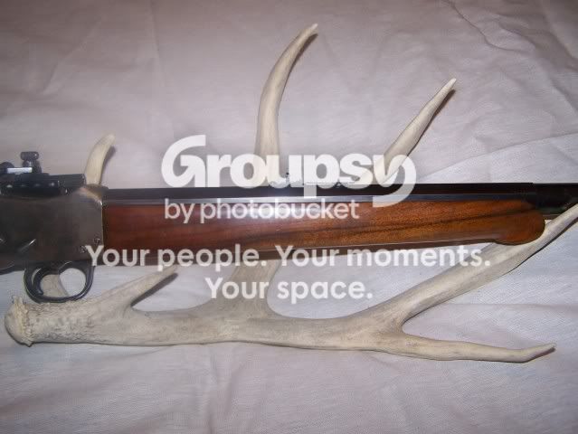

Well in a moment of insanity or maybe not I bought this old girl. I bought it to shoot not hang on a wall.

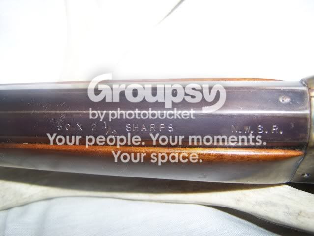

The stamp on top of the barrel is a cross
Now I always wanted one of these and always wanted a Sharps 50-90. But I'm counting on the Martini experts out there to give me any advice you can
To me it looks like a Greener martini that started as a shotgun and was rebarrled with a 50 cal barrel and chamber to the 2 1/2 straight Sharps case
If it's chambered for the 50/90 Sharps, like it says, you have a wonderful rifle in a fantastic caliber, my favorite! You will not be happy with that chambering unless you use real black powder as the case is so big. Depending on the throating and bullet you use, it can take from 95 to 110grs. to fill it. My most accurate bullet to date is a 540 gr. LBT bullet cast 30-1 and 105grs. of Swiss 1 1/2FG, for me.....I have about 10 different designs of bullets to play with and I will continue to shoot my Sharps '74 in the spring. I've fired thousands of rounds through mine and it's 12 lbs. keeps recoil down to where it's acceptable(not for the sqeemish). Mine has taken Deer, Buffalo, and Moose, animals hit with yesterdays "poison slinger" get sick and die instantly....contact me if you need any info....Ben
The last owner said It was a 50-90 Martini Greener. I doubt if it was made by Greener but it doesn't matter. I expect it started life as a shotgun. The brass I got with it says BELL 50-sharps-3 1/4 the cases are 2 1/2 inches long. The reloading dies say 50 2.5 Sharps. I have two bullet moulds and a sizing die. People who saw him shoot say it was accurate.

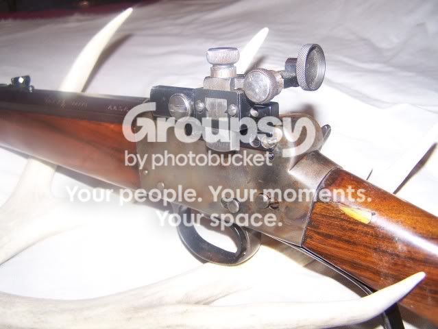

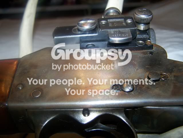

With that big paddle safety on the right side it does look a lot like a Greener shotgun conversion. But it's missing the takedown screw on the left side. Although that may have been replaced by a fixed bolt to remove the easily replaced barrel option since it's now a rifle.
I got to shoot a Pedersoly made Sharps 50-90 last Spring and fell in love with the calibre, I got to shoot 10 or 11 rounds one after another, I was hooked. Ya gotta love a gun that throws that much lead each time :)
Yes, more people on here should know about the "big .50" or "Poison slinger", and as a hunting caliber, the word "finale" comes to mind. Being a Buffalo hunter, Billy Dixon used it to knock the Indian off the horse at 1500+ yds. to end the Battle of Adobe Walls. For me 200yds. is my limit, but I have ordered a new tang sight from MVA and will try some longer shots with the 685gr. slug. The buckhorn barrel sights are not clear for my aging eyes, but the Badger barrelled C. Sharps '74 won't let me down. For the original poster, I don't know how much travel that rear peep will give you but you need about 2" for 500 yds.
Very nice gun. Much cleaner overall than my Greener 577 x 2 1/2. I would agree that it's most likely a shotgun action and therefore not an antique as far as the CFC is concerned but a nice gun either way.
