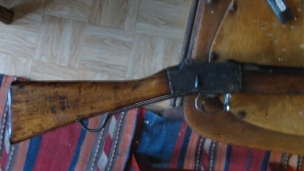

I just want to strip her down , I hope all her steel is in good shape, If the union monkeys at Can post smash up the wood, Ill just have to replace it with custom walnut p+++.

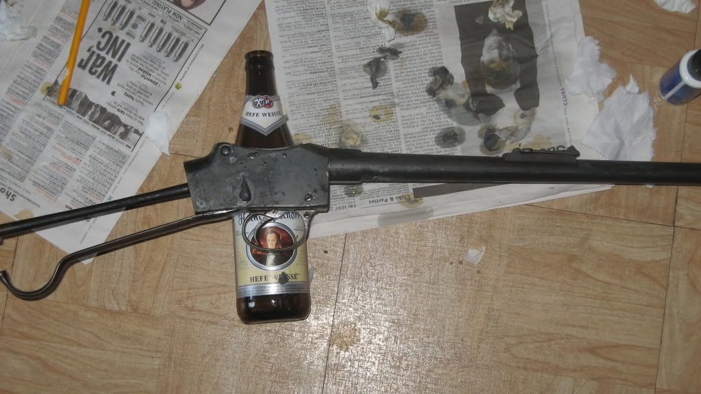

If you strip it down be careful how you do it. There are internet sites that show how to do it. What looks like a screw holding in the breach block is actually a split pin. You can do damage to your new gun if you don't understand how it goes together. Just a caution. Enjoy the thing and yes you will get more of them.

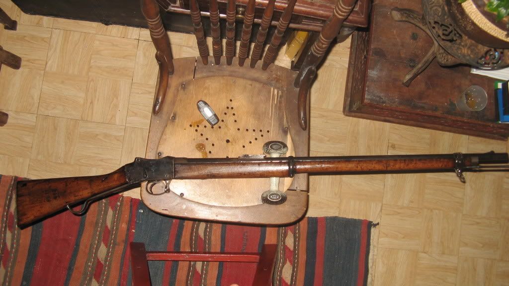

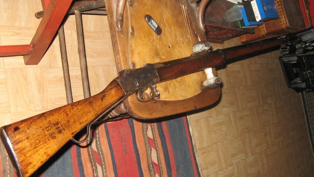

Well here she is Boys!!!
I just now have finished, she was fully stripped to the bones, every part cleaned and inspected and greased ,
her outers were given a light and semi antiquated cold blue "I may re do it but Its nice lookin so far", the forstock was tightened with oiled leather between it and the barel, I replaced the rear sling swivel with a better one "from loyalist" then the plain crappy home made jobby it came with
the stock scrubbed of 120 years of gunk-
splits repaired then stained lightly with special walnut, and as of 1/2 hour ago had its first of many hand rubbed lynseed oil sessions.
Now she awaits some field testing!!

Gun looks good Musketfire
John
Thanks!
