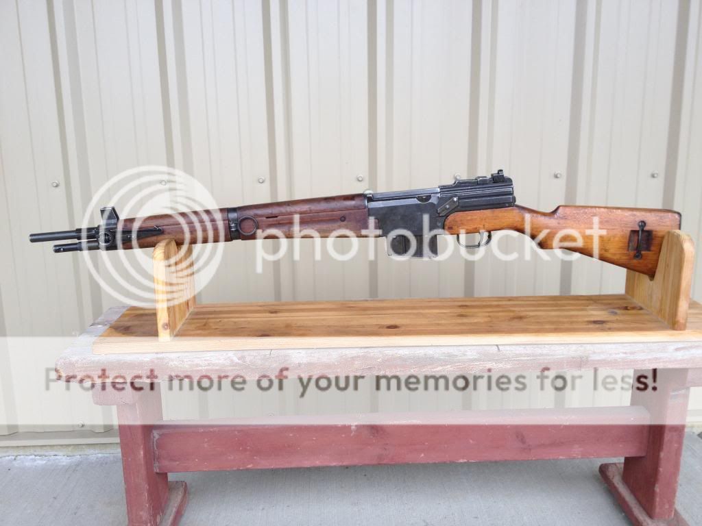

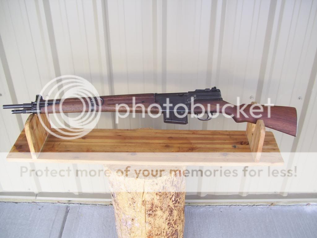

I picked up a Syrian 49, locally, last year with a FrankenBubbaed butt stock on it.
Through a little digging I managed to find a proper stock in France, but need to color match it somehow.
Have yet to shoot it, but very impressed with the robust quality of the gun.
Bought to fit into my semi-auto milsurp collection and have around $800 into it :redface: :(
Before
After
