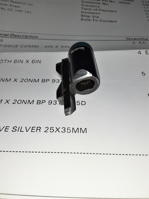

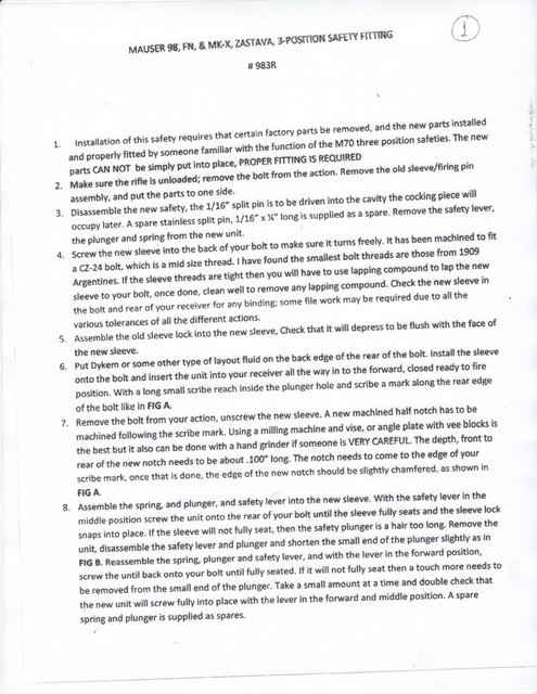

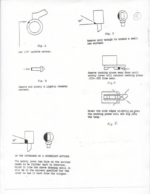

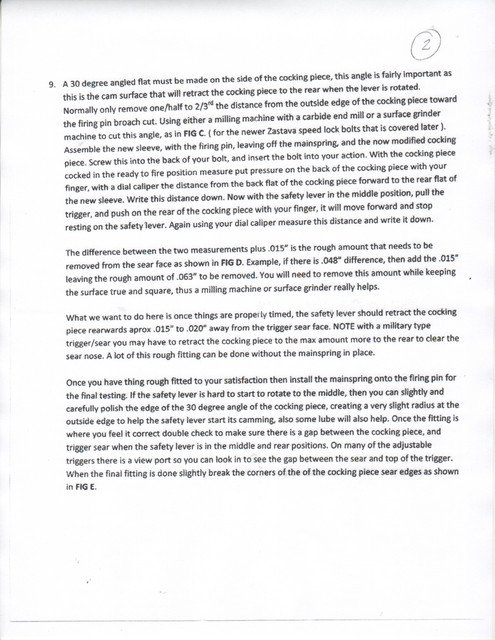

diopter CGN Ultra frequent flyer Rating - 100% 82 0 0 Location Montreal May 26, 2022 #1 Note that these drawings are for a left hand 3Position safety. I'm working on a right hand version. Putting a 30 degree bevel on the Cocking piece. Last edited: May 26, 2022
