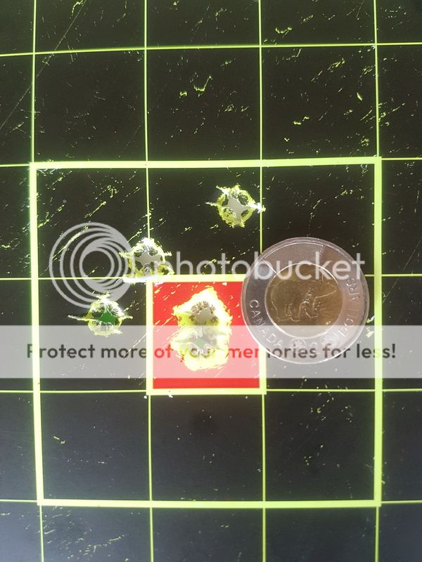

So a little update here, I now have the 15" fore end installed and got to spend some time up at the range last week. Shooting the recipe I used for my Remington I got some great groups (at least what I considered good for me) shooting 5 round groups @250yds with heavy mirage. I'm excited to start load development considering the promise this rig is showing so far
