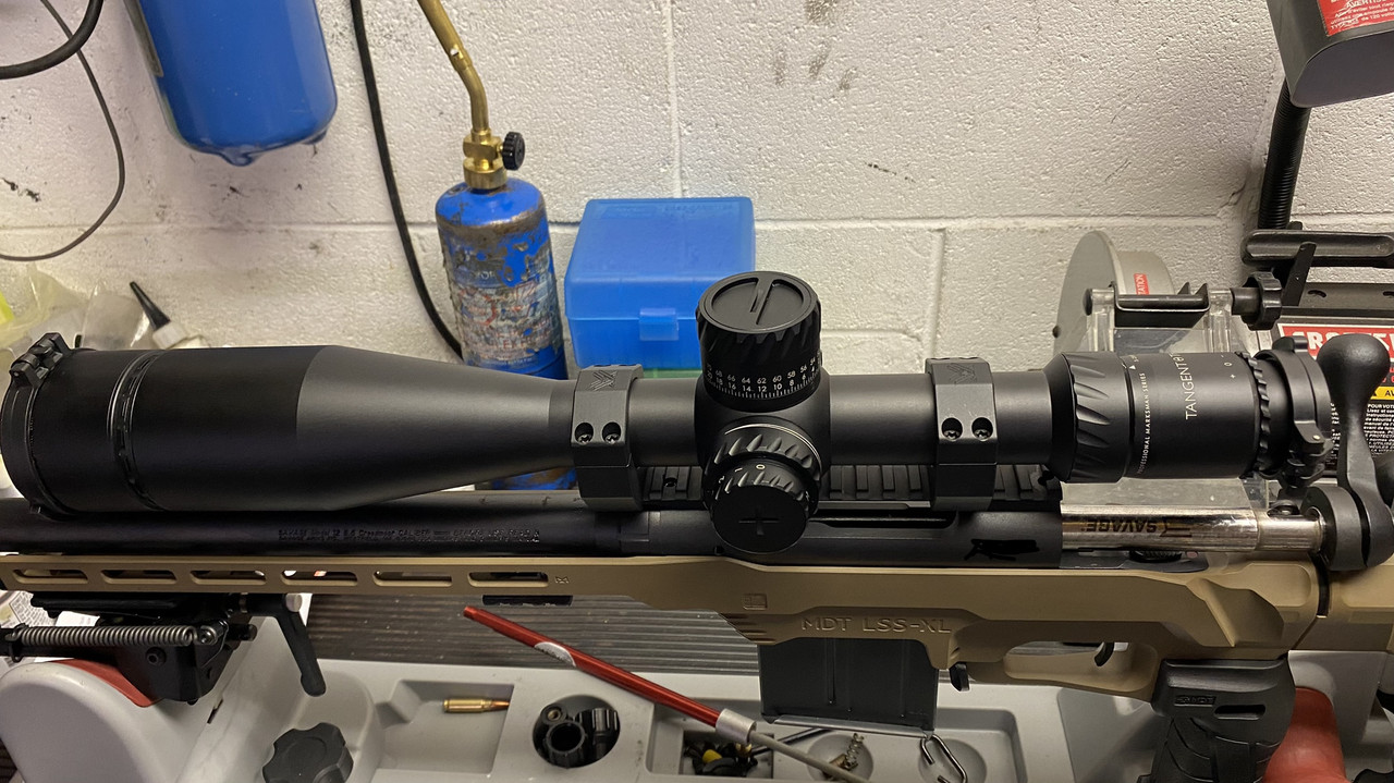

So for the past few months I've been piecing together a Remington 700 budget build and researching which rail to get I came across MDT and their 50 Moa rail. I was wondering if anybody has any experience with the quality of MDT rails, as I'm highly interested in getting one with 50 Moa.

Arken II 6-24x50 34mm. I prefer arken products, and own 3 of them. I also prefer to hold low within 200y

I'm shooting 260 handloads, I just want to have it close to dope zero as possible without adjusting it.
A 20 moa rail is plenty. That will more than get a .260 out to 1k yards. IIRC I can dial my .308 out to 1500ish yards with a 20 moa base. The 50 moa bases are for 700 pattern rimfires. MDT makes some real quality kit, I use their bases on all my 700s.
