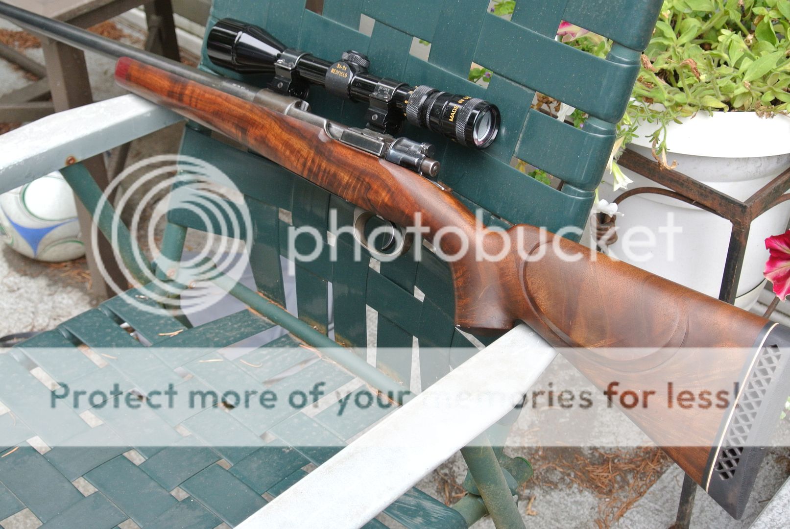

What grain of bullet are you firing in it Kevan?
Looks like the 375 whelen is right in the middle of the range of velocities I was interested in; with 5 rounds in the magazine.
