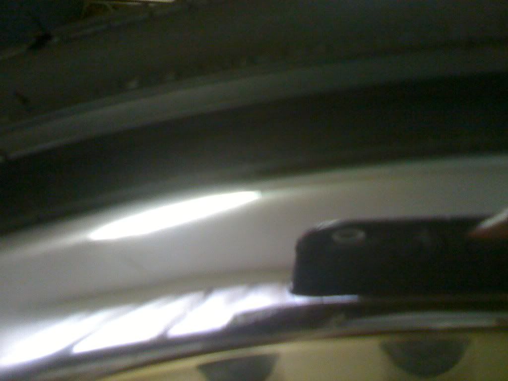

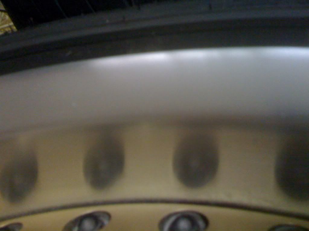

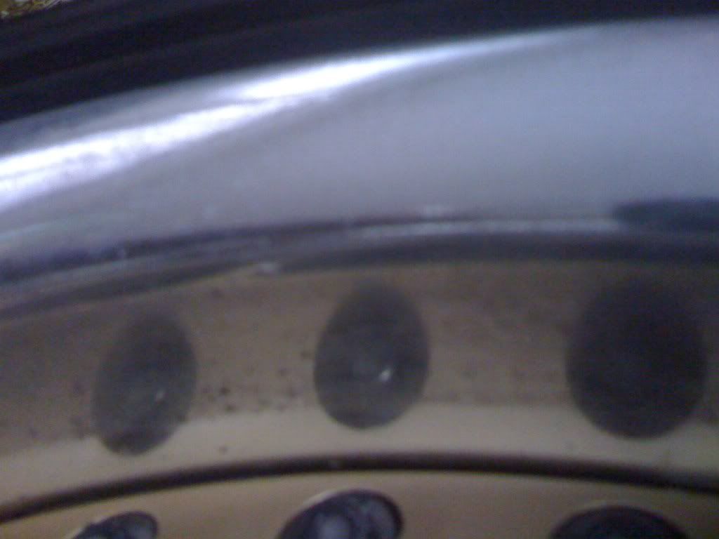

I haven't had to polish a gun yet the only thing I've done is aluminum wheels which is a lot softer. The principles still apply start at a lower grit paper and work your way up, how low you start depends on how much finish needed to be removed to flatten it out.
Just as a rough idea my wheels were heavily oxidized and crusty I went from here after washing
To here using 600-1000-2000grit
Then just some mothers mag polish on paper towels.
It could still be better if looking very closely with a magnifying glass but it was mirror already. By the time you get above 2000 you get a cloudy reflectiveness you can polish.
