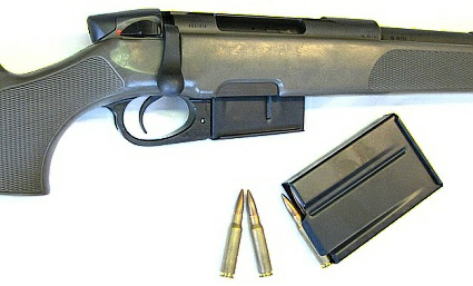

Coming soon to Canada... metal trigger guards which are designed to allow you to use AICS magazines in your Steyr SSG69 or Model L. The best ever upgrade for your iconic Steyr... and they look great!
These are manufactured in Austria by Styria Arms ... (not Steyr Arms). check them out...great reviews. As these are export regulated by the Austrian Government, an export permit is required which can take up to 2 months to be issued... so hang tight and we will keep everyone posted as they get closer.

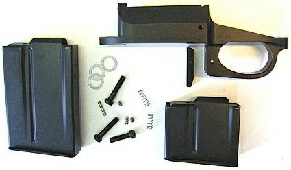

I can attest to the amazing quality of these things, having imported one myself the hard way earlier this year. They're pricey (or at least mine was), but they're extremely well made and also include two optional trigger springs that significantly reduce the pull weight -- one by a lot, and another by a scary amount. So really, you should think of the price as being for both the bottom metal and a trigger job.
One thing to consider though is that they definitely change the balance of the rifle. These things are made from a generous amount of solid steel, and they are replacing a light piece of plastic. Myself, I prefer the original rifle's balance -- but that "bottom plastic" was always the weak point on these rifles and they all end up cracking at some point. This fixes the problem ... permanently.

Higher price than the trigger guards for Remington etc but it`s a patented item, milled from a block of solid steel, hardened like a Glock slide and the only available trigger guard for SSG69.

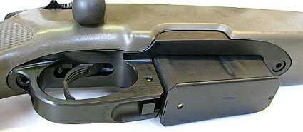

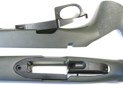

In the attachment a picture. The original plastic trigger guards always break at the screws - then they loose their tension and the gun it`s accuracy. The recoil lug is in the rear so with every shooting the screw is hard pressed against the plastic by recoil.
Worsed situation is with wooden stocks. There, first the plastic breaks, than the wood inside. And new stock for the steyr hunting rifles = carving and hand made = very expensive.
