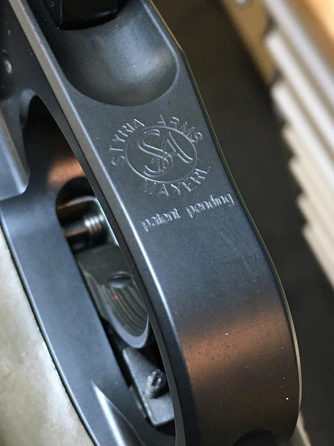

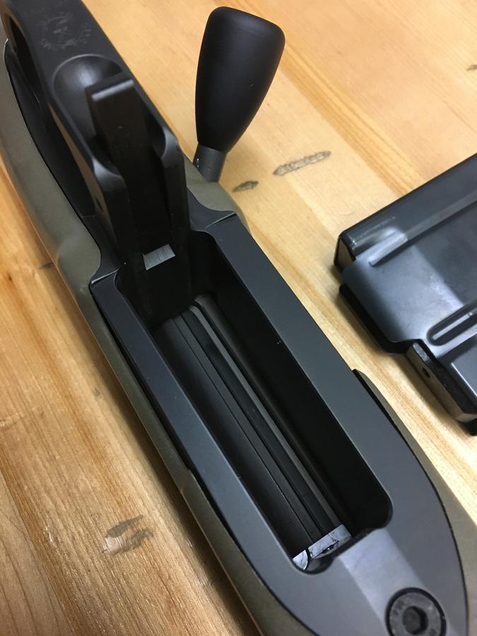

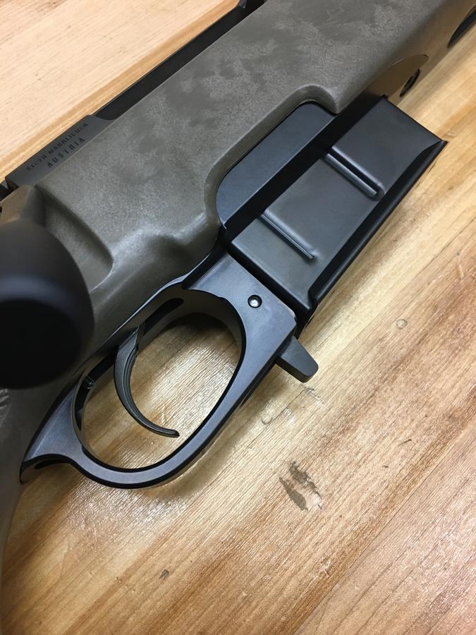

A few for now...

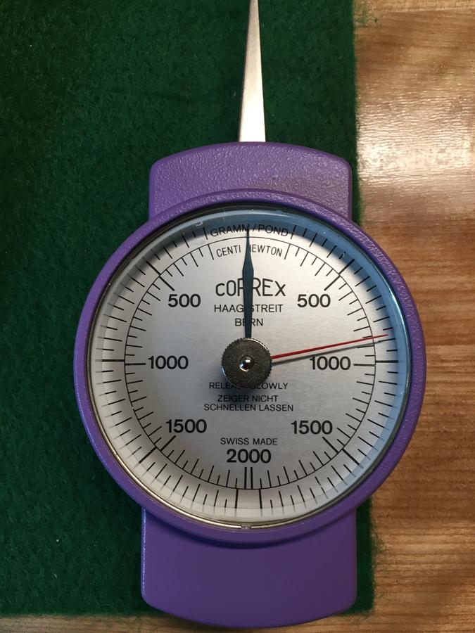

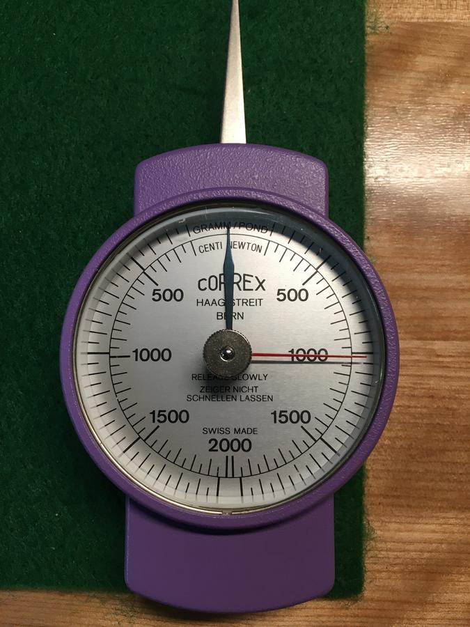

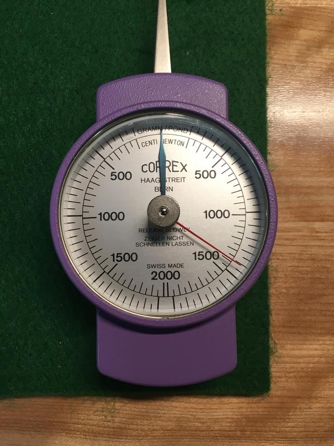

Trigger springs, I installed the lightest as I prefer a light target style trigger. Below are the weights:
Original, Heavy and Light
Bedding bolts... torque to 4Nm
Metal magazine rattle. The set screws supplied to take up the slop and work well. Once I installed them and set them, they eliminated
95% of the magazine rattle. I did not try any polymer mags, but may remove the set screws and try some Magpul AICS Mags.
