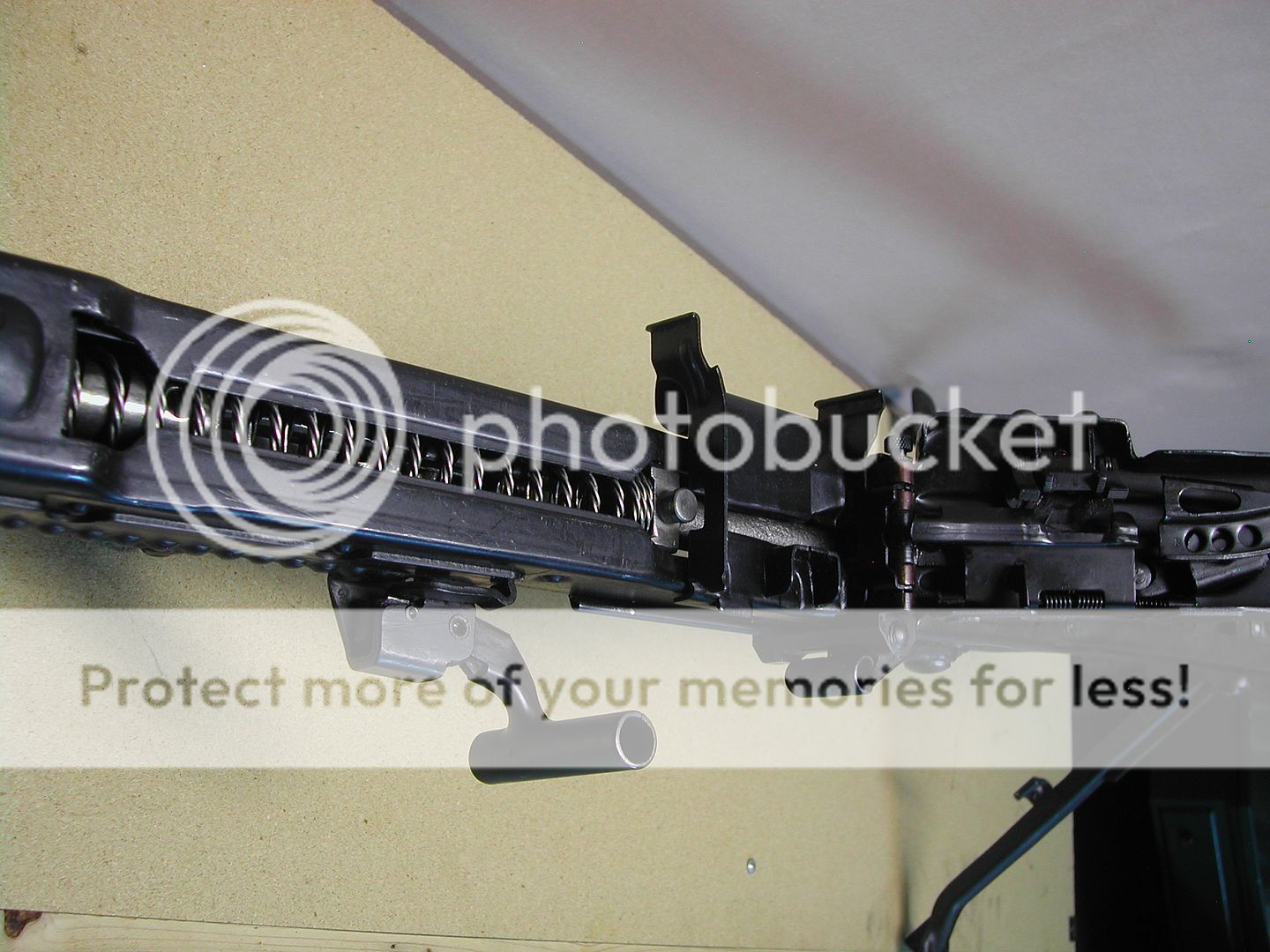

From what I understand this is the deactivation that took place on my MG42.
This comes from the guy that did the deactivation.
Procedures utilized in neutralizing the gun.
- Barrel release lever welded.
- Retaining lever for trigger group welded inside and outside to the receiver.
- Welded on under side of receiver ahead of buttstock to prevent disassembly.
- Hole drilled in the barrel ahead of the chamber, a pin was put in the hole and welded in place.
- Bolt face was ground off.
- Sear notch on bolt face was ground off.
- Sear is ground off and welded to the receiver.
- The receiver was cut on the left side and the barrel was welded to the receiver, this weld is visible on the left side of the gun.
David
This top cover opens and the action moves with a very healthy bolt spring.

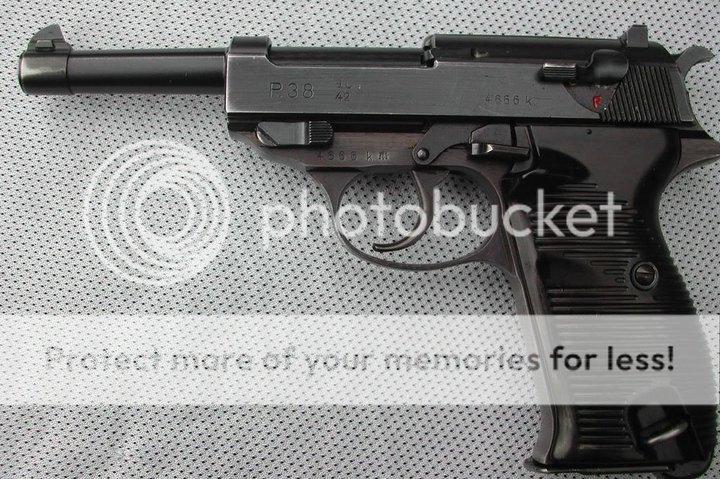

This MG42 was assembled by Gustloff in 1943 with a 'K' block Walther code ac42 P.38.
The ac42.
