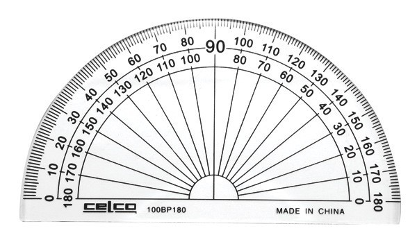

Beyond that there is no reason to think about inches or cm or relate them to mils or MOA if you're using a modern FFP tactical scope. The reticle is basically a protractor that is calibrated in mils or MOA (angles). If you want to find an angle, it is easier to use one of these and just measure it?
Or is it easier to estimate rise and run and try to calculating the angle from the estimated linear values? That's exactly what you're doing when you think in inches and try to convert to an angle (mils or MOA). It's a silly and inaccurate way of doing things when you're not shooting at canned targets and canned distances.
