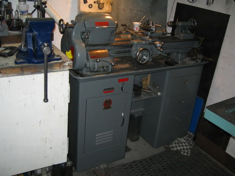

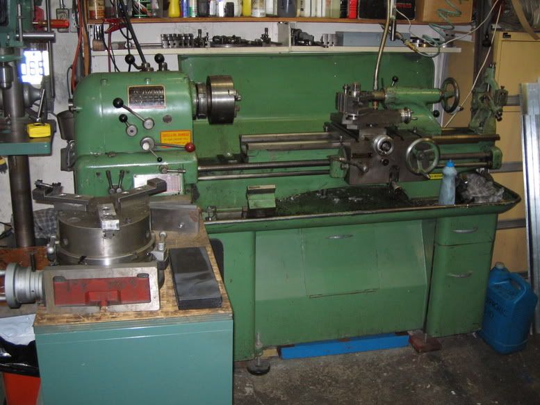

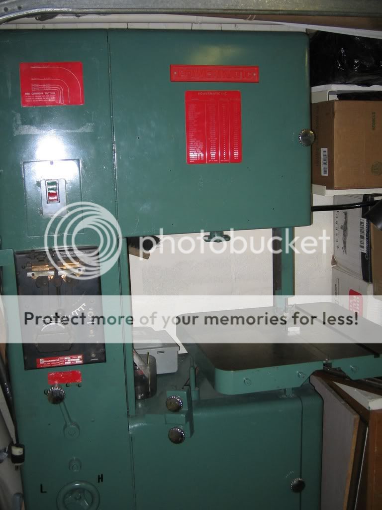

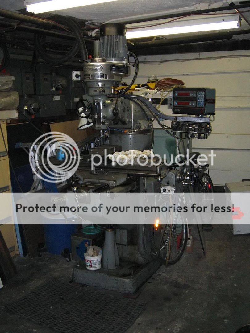

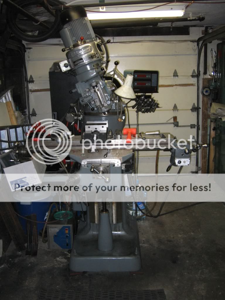

Thanks for the compliments gentlemen, but the shop is my fathers and all credit is his, I just use it.
Yes that is a 13"x36" Colchester and the little gray one is a South Bend Model A Precision Lathe, the mill is a Bridgeport, the big bandsaw is a Powermatic 20" model 87, we got another bandsaw behind the mill (it's a horizontal 7"x12"), a compressed air system and a couple of drill presses.
